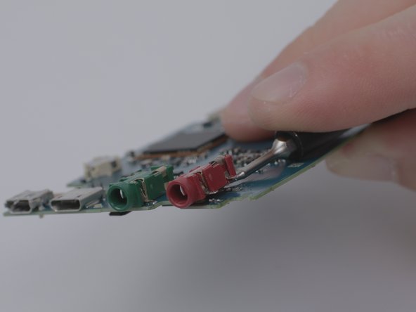

  19. Sony a7 AV Port Replacement, AV Port: crwdns2935265:019crwdnd2935265:01crwdnd2935265:02crwdne2935265:0 Sony a7 AV Port Replacement, AV Port: crwdns2935265:019crwdnd2935265:02crwdnd2935265:02crwdne2935265:0
    • Take a soldering iron and place it onto a leg of the failed AV port.
    • Use a small flat head screwdriver to pry up each leg while the solder is molten.
    • The soldering iron and solder will be hot, exercise extreme caution when handling.
    • Always wear eye protection when soldering connections, solder can splatter and cause burns.
    • Do not inhale any smoke or fumes that may be given off during the soldering process, as they can be toxic.
    • For help and tips on how to effectively solder like a professional, please reference the iFixit guide on soldering here.
  20. Sony a7 AV Port Replacement: crwdns2935265:020crwdnd2935265:01crwdnd2935265:01crwdne2935265:0
    • Repeat the actions in the previous step to the remaining three legs of the faulty AV port until the connector is able to be moved, and is free.
    • All of the tips and cautions about the soldering process still apply in this step, continue to exercise extreme due diligence and caution.
