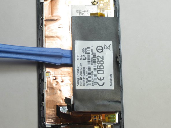

  11. Sony Xperia Sola Battery Replacement, Remove and replace the battery.: crwdns2935265:011crwdnd2935265:01crwdnd2935265:03crwdne2935265:0 Sony Xperia Sola Battery Replacement, Remove and replace the battery.: crwdns2935265:011crwdnd2935265:02crwdnd2935265:03crwdne2935265:0 Sony Xperia Sola Battery Replacement, Remove and replace the battery.: crwdns2935265:011crwdnd2935265:03crwdnd2935265:03crwdne2935265:0
    • To remove the battery, slide a flat object under the battery and lift it. The plastic opening tool will be the best tool for this task.
    • It is possible that the battery may be glued to the phone. If this is the case, use isopropyl alcohol or adhesive remover underneath the battery to soften the adhesive, then use a suction cup to lift the battery out.
    • If that doesn't work, apply low heat to soften the glue and allow removal without breaking the battery. To heat the glue, use a simple hair dryer, but be very careful not to overheat the phone or damage any components.
    • Using heat on a battery for too long can be dangerous and may also damage other parts of the phone.
