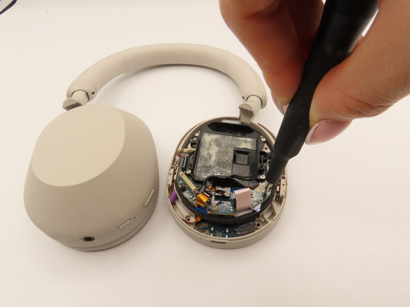

    • Use a Phillips #000 screwdriver to remove the eight screws along the outer inside edge.
    • There is a piece of grey foam you can simply remove to uncover the centre 4 screws.
    • Flip the headphones to the other side and slowly lift up the back plastic cover piece.
    • Gently disconnect the touch sensor ribbon cable by pulling it out evenly from the main board.

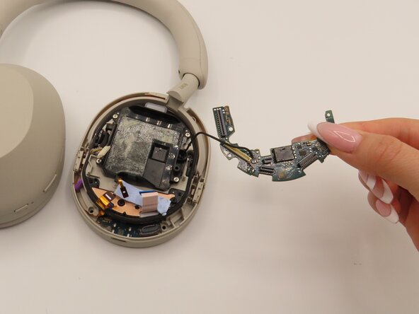

  4. Sony WH-1000XM5 Power Board Replacement, Power Board: crwdns2935265:04crwdnd2935265:01crwdnd2935265:01crwdne2935265:0

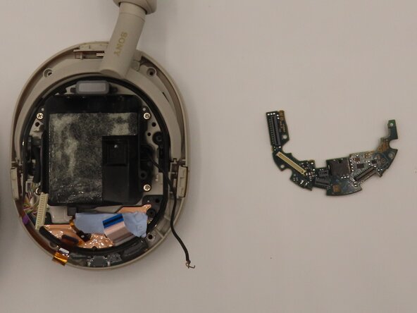

    • Unplug the main wire and all ribbons from the power board.
  5. Sony WH-1000XM5 Power Board Replacement: crwdns2935265:05crwdnd2935265:01crwdnd2935265:03crwdne2935265:0 Sony WH-1000XM5 Power Board Replacement: crwdns2935265:05crwdnd2935265:02crwdnd2935265:03crwdne2935265:0 Sony WH-1000XM5 Power Board Replacement: crwdns2935265:05crwdnd2935265:03crwdnd2935265:03crwdne2935265:0
    • Use a Phillips #000 screwdriver to remove the two black 1.6mm Phillips screws holding the power board down.
    • Carefully lift the power board from the unit.
  6. Sony WH-1000XM5 Power Board Replacement: crwdns2935265:06crwdnd2935265:01crwdnd2935265:02crwdne2935265:0 Sony WH-1000XM5 Power Board Replacement: crwdns2935265:06crwdnd2935265:02crwdnd2935265:02crwdne2935265:0
    • Before you begin soldering, note the following safety precautions:
    • Always unplug, turn off, and remove power sources before soldering.
    • Do not touch the metal part of the soldering iron! The soldering iron can heat up to over 310°C (600°F).
    • Be extremely careful when you are soldering/desoldering lithium-polymer battery wires! You can easily short the battery with solder or your tools, resulting in battery damage and a fire hazard.
    • Plug in the soldering iron and wait 1-3 minutes for it to heat up.
    • Place the flat side of the soldering iron on the 2 globs of metal for 2-3 seconds as shown.
    • While the globs are still hot, use your tweezers to carefully detach the black and red wires from the power board.
