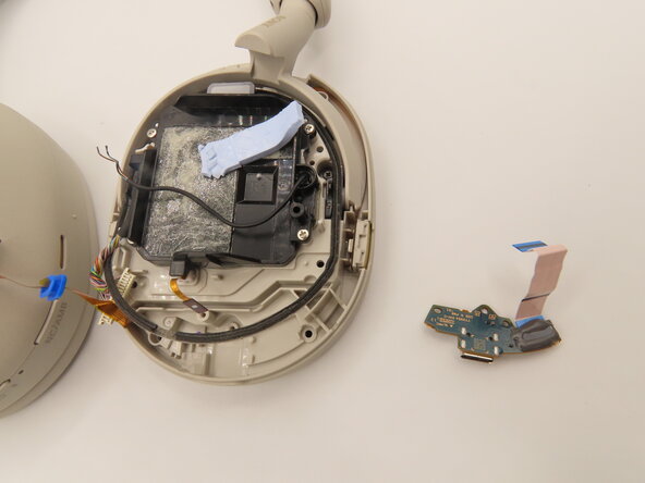

  3. Sony WH-1000XM5 Charging Board Replacement: crwdns2935265:03crwdnd2935265:01crwdnd2935265:03crwdne2935265:0 Sony WH-1000XM5 Charging Board Replacement: crwdns2935265:03crwdnd2935265:02crwdnd2935265:03crwdne2935265:0 Sony WH-1000XM5 Charging Board Replacement: crwdns2935265:03crwdnd2935265:03crwdnd2935265:03crwdne2935265:0
    • Peel off the tape covering the battery connector.
    • Pull out the battery and disconnect the battery cable from the motherboard.
  4. Sony WH-1000XM5 Charging Board Replacement, Power Board: crwdns2935265:04crwdnd2935265:01crwdnd2935265:01crwdne2935265:0
    • Unplug the main wire and all ribbons from the power board.
  5. Sony WH-1000XM5 Charging Board Replacement: crwdns2935265:05crwdnd2935265:01crwdnd2935265:03crwdne2935265:0 Sony WH-1000XM5 Charging Board Replacement: crwdns2935265:05crwdnd2935265:02crwdnd2935265:03crwdne2935265:0 Sony WH-1000XM5 Charging Board Replacement: crwdns2935265:05crwdnd2935265:03crwdnd2935265:03crwdne2935265:0
    • Use a Phillips #000 screwdriver to remove the two black 1.6mm Phillips screws holding the power board down.
    • Carefully lift the power board from the unit.

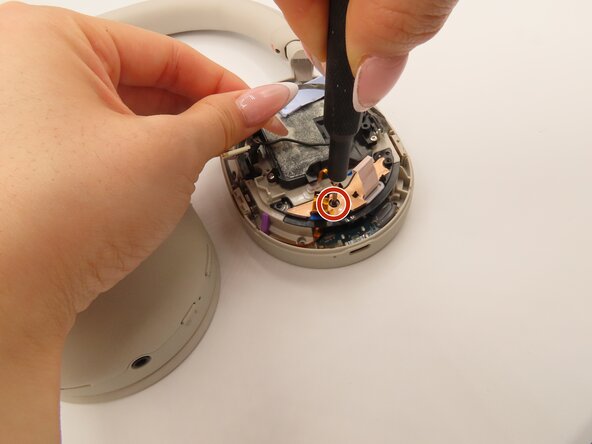

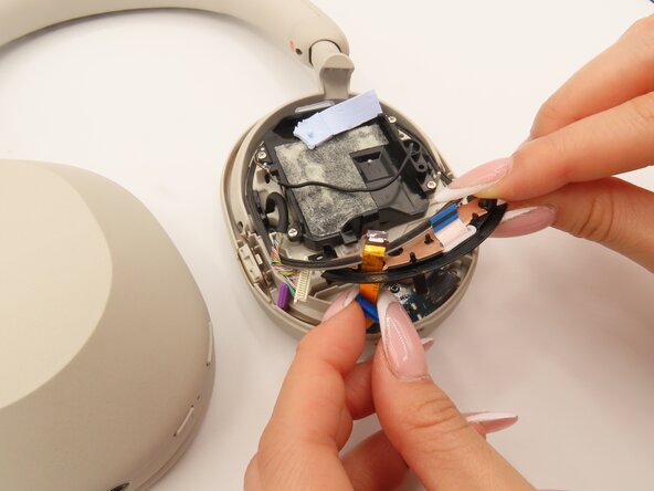

  7. Sony WH-1000XM5 Charging Board Replacement, Charging Board: crwdns2935265:07crwdnd2935265:01crwdnd2935265:03crwdne2935265:0 Sony WH-1000XM5 Charging Board Replacement, Charging Board: crwdns2935265:07crwdnd2935265:02crwdnd2935265:03crwdne2935265:0 Sony WH-1000XM5 Charging Board Replacement, Charging Board: crwdns2935265:07crwdnd2935265:03crwdnd2935265:03crwdne2935265:0
    • Set the blue sticky strips to the side.
    • Use a spudger to lift up the dark gray mesh from the back plastic part.
    • Use a Phillips #000 screwdriver to remove the 1.6 mm screw in the center.
    • Carefully pull the ribbons through.
  8. Sony WH-1000XM5 Charging Board Replacement: crwdns2935265:08crwdnd2935265:01crwdnd2935265:02crwdne2935265:0 Sony WH-1000XM5 Charging Board Replacement: crwdns2935265:08crwdnd2935265:02crwdnd2935265:02crwdne2935265:0
