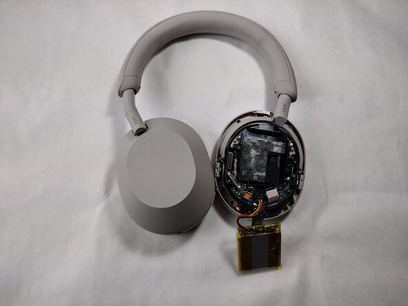

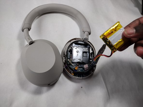

      • Peel off the tape covering the battery connector.
      • Pull out the battery and disconnect the battery cable from the motherboard.
For optimal performance, after completing this guide, calibrate your newly installed battery.
