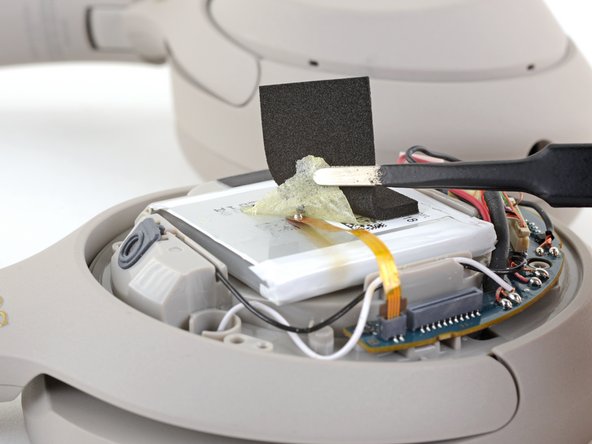

  12. Sony WH-1000XM4 Battery Replacement, Remove the thermal sensor: crwdns2935265:012crwdnd2935265:01crwdnd2935265:03crwdne2935265:0 Sony WH-1000XM4 Battery Replacement, Remove the thermal sensor: crwdns2935265:012crwdnd2935265:02crwdnd2935265:03crwdne2935265:0 Sony WH-1000XM4 Battery Replacement, Remove the thermal sensor: crwdns2935265:012crwdnd2935265:03crwdnd2935265:03crwdne2935265:0
    • If your replacement battery doesn't come with a thermal sensor preinstalled, you'll need to transfer your old one over from your old battery.
    • Whenever you use tweezers near the battery, be very careful not to puncture the battery.
    • Use a pair of tweezers to peel back the foam and adhesive covering the battery thermal sensor.
    • During reinstallation, make sure the diode on the end of the thermal sensor flex cable is facing up.
  13. Sony WH-1000XM4 Battery Replacement: crwdns2935265:013crwdnd2935265:01crwdnd2935265:02crwdne2935265:0 Sony WH-1000XM4 Battery Replacement: crwdns2935265:013crwdnd2935265:02crwdnd2935265:02crwdne2935265:0
    • Use a pair of tweezers to pull up on the thermal sensor ribbon cable to disconnect it from the main board.
    • Pull only on the darker pull-tab section of the cable, not the cable itself.
    • Remove the thermal sensor.
