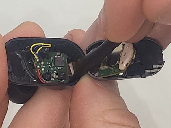

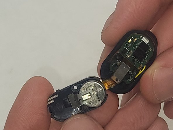

  2. Sony WF-1000XM3 Main Board Replacement: crwdns2935265:02crwdnd2935265:01crwdnd2935265:03crwdne2935265:0 Sony WF-1000XM3 Main Board Replacement: crwdns2935265:02crwdnd2935265:02crwdnd2935265:03crwdne2935265:0 Sony WF-1000XM3 Main Board Replacement: crwdns2935265:02crwdnd2935265:03crwdnd2935265:03crwdne2935265:0
    • Use a Phillips #000 screwdriver to remove the two 4 mm screws securing the internal components.
    • Both sides of the earbuds are attached with a ribbon cable. Separate the two halves carefully to prevent tearing the cable.

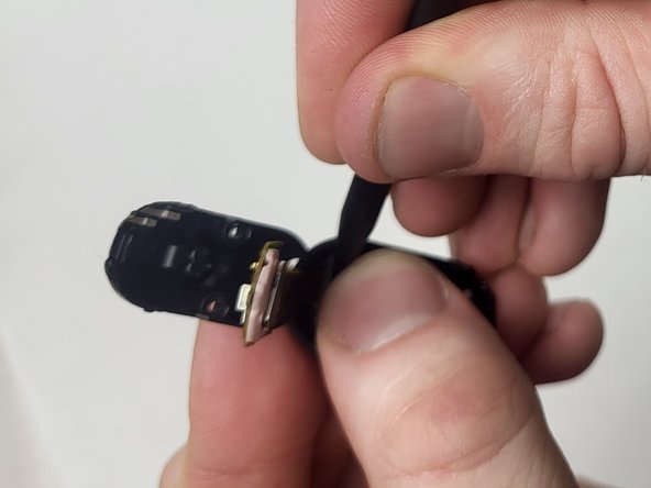

  3. Sony WF-1000XM3 Main Board Replacement: crwdns2935265:03crwdnd2935265:01crwdnd2935265:02crwdne2935265:0 Sony WF-1000XM3 Main Board Replacement: crwdns2935265:03crwdnd2935265:02crwdnd2935265:02crwdne2935265:0
    • Use a spudger to carefully remove the battery from the earbud's circuit board.
    • When replacing the battery, make sure to keep the same orientation as the old battery and reconnect the battery to the circuit board.

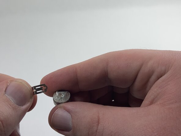

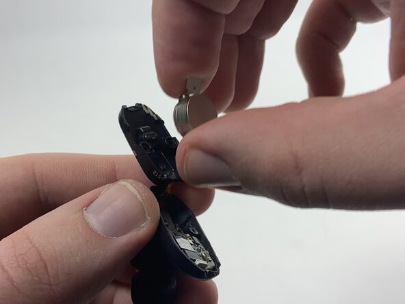

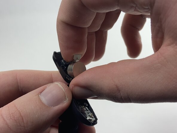

  4. Sony WF-1000XM3 Main Board Replacement: crwdns2935265:04crwdnd2935265:01crwdnd2935265:03crwdne2935265:0 Sony WF-1000XM3 Main Board Replacement: crwdns2935265:04crwdnd2935265:02crwdnd2935265:03crwdne2935265:0 Sony WF-1000XM3 Main Board Replacement: crwdns2935265:04crwdnd2935265:03crwdnd2935265:03crwdne2935265:0
    • Use a spudger to pry the battery and the metal negative contact from the earbud.
    • The battery and the negative contact are secured with double-sided tape, so it may take some force to remove them.

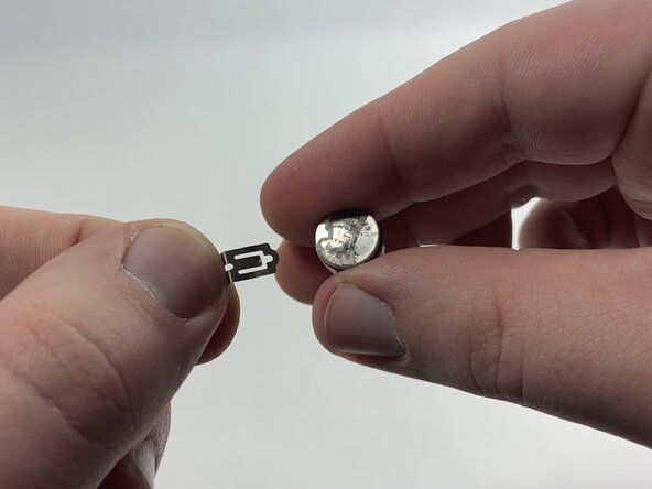

  5. Sony WF-1000XM3 Main Board Replacement: crwdns2935265:05crwdnd2935265:01crwdnd2935265:03crwdne2935265:0 Sony WF-1000XM3 Main Board Replacement: crwdns2935265:05crwdnd2935265:02crwdnd2935265:03crwdne2935265:0 Sony WF-1000XM3 Main Board Replacement: crwdns2935265:05crwdnd2935265:03crwdnd2935265:03crwdne2935265:0
    • Remove the metal negative terminal from the battery.
    • Attach it to the new battery, either with double-sided tape or by placing the new battery and the terminal back into the earbud in the same position they were before.

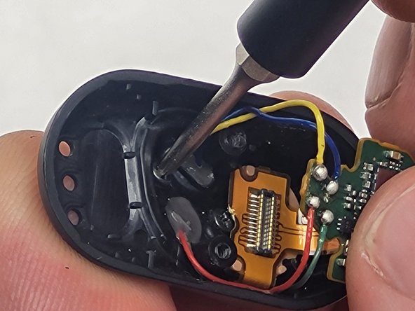

  6. Sony WF-1000XM3 Main Board Replacement, Main Board: crwdns2935265:06crwdnd2935265:01crwdnd2935265:03crwdne2935265:0 Sony WF-1000XM3 Main Board Replacement, Main Board: crwdns2935265:06crwdnd2935265:02crwdnd2935265:03crwdne2935265:0 Sony WF-1000XM3 Main Board Replacement, Main Board: crwdns2935265:06crwdnd2935265:03crwdnd2935265:03crwdne2935265:0
    • Use the spudger and tweezers to remove the small connectors that hold the main board in place.
    • If your device contains soldered components, carefully desolder them with the soldering iron.
    • Gently remove the main board.
