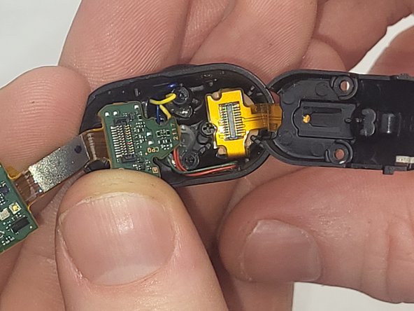

    • Use a spudger to gently pry open the back plate of the earbud.
  2. Sony WF-1000XM3 Earbud Speaker Replacement: crwdns2935265:02crwdnd2935265:01crwdnd2935265:03crwdne2935265:0 Sony WF-1000XM3 Earbud Speaker Replacement: crwdns2935265:02crwdnd2935265:02crwdnd2935265:03crwdne2935265:0 Sony WF-1000XM3 Earbud Speaker Replacement: crwdns2935265:02crwdnd2935265:03crwdnd2935265:03crwdne2935265:0
    • Use a Phillips #000 screwdriver to remove the two 4 mm screws securing the internal components.
    • Both sides of the earbuds are attached with a ribbon cable. Separate the two halves carefully to prevent tearing the cable.
  3. Sony WF-1000XM3 Earbud Speaker Replacement: crwdns2935265:03crwdnd2935265:01crwdnd2935265:02crwdne2935265:0 Sony WF-1000XM3 Earbud Speaker Replacement: crwdns2935265:03crwdnd2935265:02crwdnd2935265:02crwdne2935265:0
    • Use a spudger to carefully remove the battery from the earbud's circuit board.
    • When replacing the battery, make sure to keep the same orientation as the old battery and reconnect the battery to the circuit board.
  4. Sony WF-1000XM3 Earbud Speaker Replacement: crwdns2935265:04crwdnd2935265:01crwdnd2935265:03crwdne2935265:0 Sony WF-1000XM3 Earbud Speaker Replacement: crwdns2935265:04crwdnd2935265:02crwdnd2935265:03crwdne2935265:0 Sony WF-1000XM3 Earbud Speaker Replacement: crwdns2935265:04crwdnd2935265:03crwdnd2935265:03crwdne2935265:0
    • Use a spudger to pry the battery and the metal negative contact from the earbud.
    • The battery and the negative contact are secured with double-sided tape, so it may take some force to remove them.
  5. Sony WF-1000XM3 Earbud Speaker Replacement: crwdns2935265:05crwdnd2935265:01crwdnd2935265:03crwdne2935265:0 Sony WF-1000XM3 Earbud Speaker Replacement: crwdns2935265:05crwdnd2935265:02crwdnd2935265:03crwdne2935265:0 Sony WF-1000XM3 Earbud Speaker Replacement: crwdns2935265:05crwdnd2935265:03crwdnd2935265:03crwdne2935265:0
    • Remove the metal negative terminal from the battery.
    • Attach it to the new battery, either with double-sided tape or by placing the new battery and the terminal back into the earbud in the same position they were before.
  6. Sony WF-1000XM3 Earbud Speaker Replacement, Earbud Speaker: crwdns2935265:06crwdnd2935265:01crwdnd2935265:02crwdne2935265:0 Sony WF-1000XM3 Earbud Speaker Replacement, Earbud Speaker: crwdns2935265:06crwdnd2935265:02crwdnd2935265:02crwdne2935265:0
    • Identify the speaker unit's location as well as positioning on the main board
    • Heat the soldering iron to the proper temperature
  7. Sony WF-1000XM3 Earbud Speaker Replacement: crwdns2935265:07crwdnd2935265:01crwdnd2935265:02crwdne2935265:0 Sony WF-1000XM3 Earbud Speaker Replacement: crwdns2935265:07crwdnd2935265:02crwdnd2935265:02crwdne2935265:0
    • Using the desoldering braid remove the soldering connecting the speaker unit to the main board.
    • Using a plastic spudger, gently remove the speaker unit from the main board.
