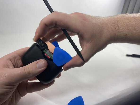

    • Use plastic opening picks to release the locking mechanism that secures the plastic shell of the charging case to its internal components.
    • Use a spudger to release the final lock and slide out the internal components of the charging case.

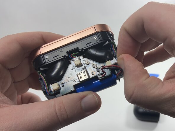

    • Use the point of a spudger to push on alternating sides of each connector to "walk" it out of its socket.
    • Do not pull on the cables as they may come loose.
    • To reconnect the cable, align the connector and use a spudger or clean fingernail to push it fully into the socket.

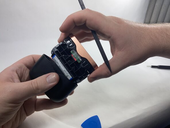

    • Use a plastic spudger to carefully remove the battery from the double-sided tape securing it in place, then remove it from the battery compartment.

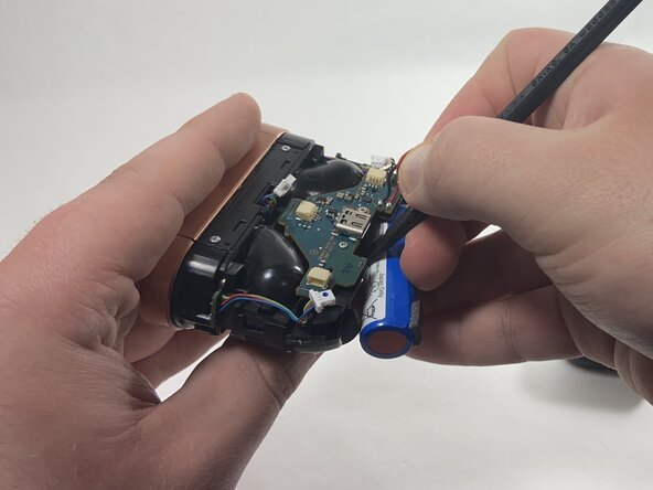

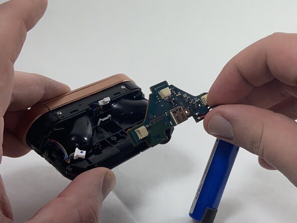

    • Remove the two metal 3 mm screws from the motherboard using a Phillips #000 screwdriver.
    • Remove the motherboard and battery assembly from the battery case

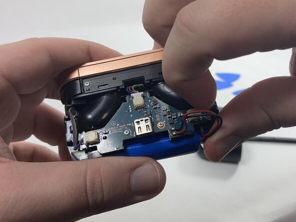

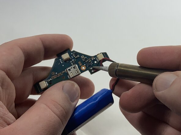

    • Desolder the red and black wires that connect the battery to the motherboard.
    • Solder the wires from the replacement battery into the circuit board following the same configuration.
    • Position the battery so that the raised section faces inward, allowing the case to fully seal.
    • Do not let ends of the wires of either battery touch, as they may spark and cause a fire.

what kind of battery is in the case?
Bóas Kár Ketilsson - crwdns2934203:0crwdne2934203:0
What is the battery model of the battery?
Rafael Romero Flores - crwdns2934203:0crwdne2934203:0
14500 3.7v, as seen in the battery label on Step 2
