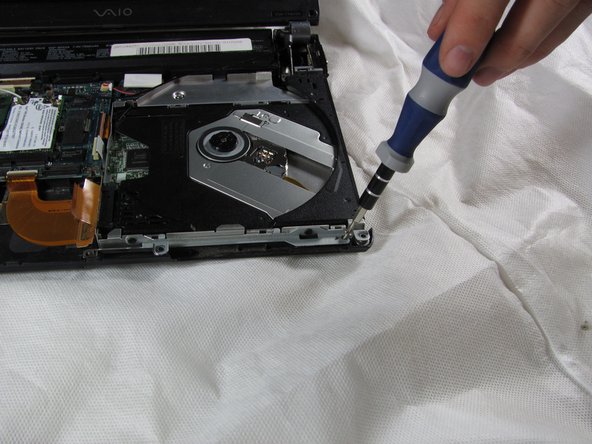

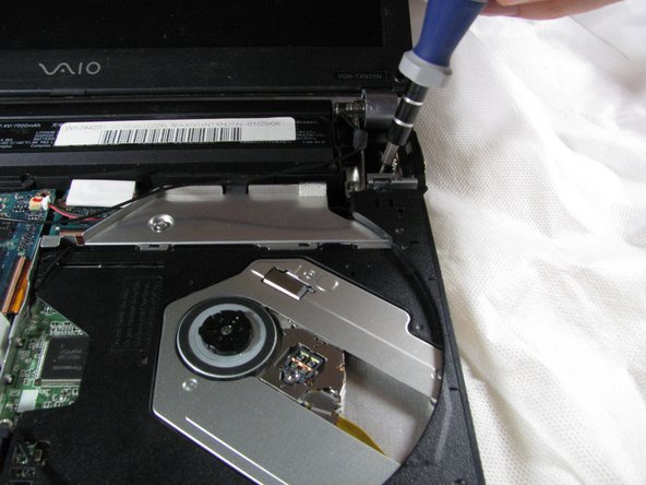

  15. Sony Vaio VGN-TXN25N Optical Drive Replacement, Optical Drive: crwdns2935265:015crwdnd2935265:01crwdnd2935265:03crwdne2935265:0 Sony Vaio VGN-TXN25N Optical Drive Replacement, Optical Drive: crwdns2935265:015crwdnd2935265:02crwdnd2935265:03crwdne2935265:0 Sony Vaio VGN-TXN25N Optical Drive Replacement, Optical Drive: crwdns2935265:015crwdnd2935265:03crwdnd2935265:03crwdne2935265:0
    • Remove the 3 indicated screws.
    • There are two small scews arounds the edge and one is on top of the optical drive.

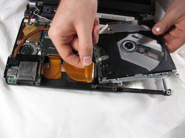

  16. Sony Vaio VGN-TXN25N Optical Drive Replacement: crwdns2935265:016crwdnd2935265:01crwdnd2935265:02crwdne2935265:0 Sony Vaio VGN-TXN25N Optical Drive Replacement: crwdns2935265:016crwdnd2935265:02crwdnd2935265:02crwdne2935265:0
    • Remove the optical drive from resting positions.
    • Gently remove cord.
