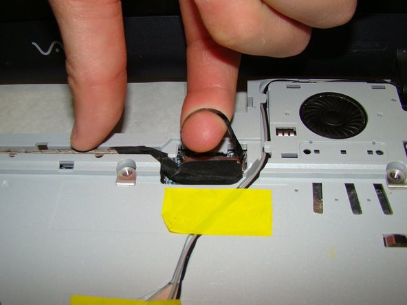

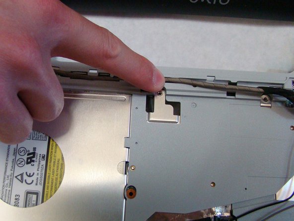

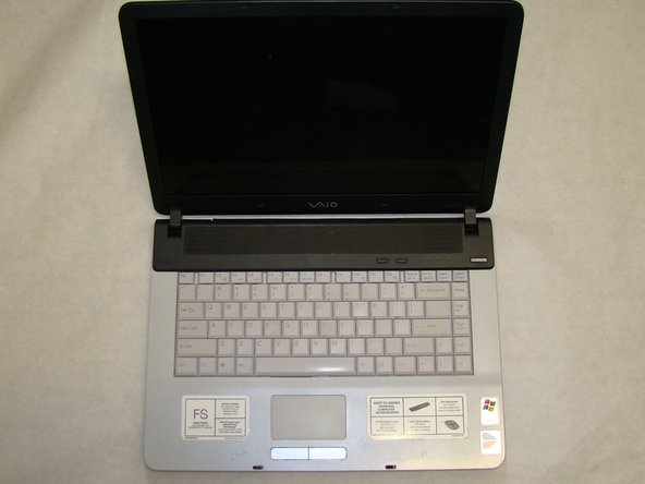

    1. Sony Vaio VGN-FS640 LCD Screen Replacement, LCD Screen: crwdns2935265:019crwdnd2935265:01crwdnd2935265:01crwdne2935265:0
      • At this point the speaker cover and keyboard should be removed and the laptop should be sitting in its normal open position with the screen facing you.
    2. Sony Vaio VGN-FS640 LCD Screen Replacement: crwdns2935265:020crwdnd2935265:01crwdnd2935265:03crwdne2935265:0 Sony Vaio VGN-FS640 LCD Screen Replacement: crwdns2935265:020crwdnd2935265:02crwdnd2935265:03crwdne2935265:0 Sony Vaio VGN-FS640 LCD Screen Replacement: crwdns2935265:020crwdnd2935265:03crwdnd2935265:03crwdne2935265:0
      • Pull the fabric loop connected to the power cable to remove the power cable jack from its connection.
      • This may require a moderate amount of force. For best results, hook your finger through the loop (as shown) and pull directly upwards.

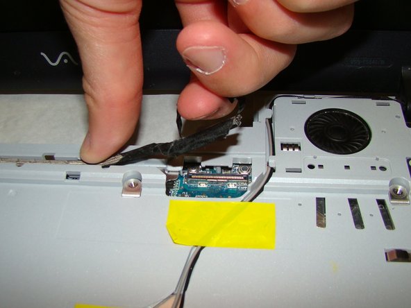

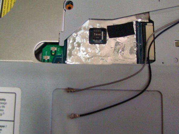

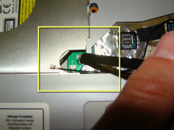

    3. Sony Vaio VGN-FS640 LCD Screen Replacement: crwdns2935265:021crwdnd2935265:01crwdnd2935265:03crwdne2935265:0 Sony Vaio VGN-FS640 LCD Screen Replacement: crwdns2935265:021crwdnd2935265:02crwdnd2935265:03crwdne2935265:0 Sony Vaio VGN-FS640 LCD Screen Replacement: crwdns2935265:021crwdnd2935265:03crwdnd2935265:03crwdne2935265:0
      • Use your fingers to pull the LCD screen's display cables away from their connections.
      • Grip the wires as close to the connectors as possible to avoid breaking the display cables.

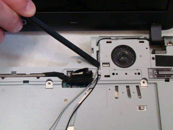

    4. Sony Vaio VGN-FS640 LCD Screen Replacement: crwdns2935265:022crwdnd2935265:01crwdnd2935265:02crwdne2935265:0 Sony Vaio VGN-FS640 LCD Screen Replacement: crwdns2935265:022crwdnd2935265:02crwdnd2935265:02crwdne2935265:0
      • Remove the two pieces of tape that hold the display cables in their slot.
    5. Sony Vaio VGN-FS640 LCD Screen Replacement: crwdns2935265:023crwdnd2935265:01crwdnd2935265:01crwdne2935265:0
      • Pull the power and display cables out of their respective grooves in the body of the laptop so that they are only connected to the screen assembly.

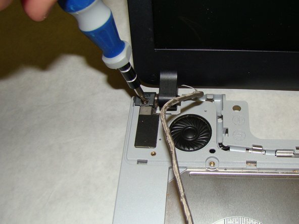

    6. Sony Vaio VGN-FS640 LCD Screen Replacement: crwdns2935265:024crwdnd2935265:01crwdnd2935265:03crwdne2935265:0 Sony Vaio VGN-FS640 LCD Screen Replacement: crwdns2935265:024crwdnd2935265:02crwdnd2935265:03crwdne2935265:0 Sony Vaio VGN-FS640 LCD Screen Replacement: crwdns2935265:024crwdnd2935265:03crwdnd2935265:03crwdne2935265:0

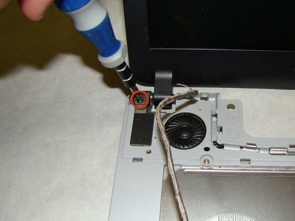

      • Use a Phillips #0 screwdriver to remove the two screws (Length: 6.9 mm) that attach the screen to the body of the laptop.
      • Do not discard these screws. They will be used to attach the new screen to the laptop.

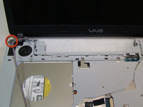

    7. Sony Vaio VGN-FS640 LCD Screen Replacement: crwdns2935265:025crwdnd2935265:01crwdnd2935265:01crwdne2935265:0
      • The LCD screen is now completely disconnected from the laptop.
      • Move the old display out of the way so you can install the new display.
    8. Sony Vaio VGN-FS640 LCD Screen Replacement: crwdns2935265:026crwdnd2935265:01crwdnd2935265:02crwdne2935265:0 Sony Vaio VGN-FS640 LCD Screen Replacement: crwdns2935265:026crwdnd2935265:02crwdnd2935265:02crwdne2935265:0
      • To install the new LCD Screen, first align the new screen with the vacated screw holes.
      • Use a Phillips #0 screwdriver to reinsert the screws(Length: 6.9 mm)and secure the new screen to the body of the laptop.

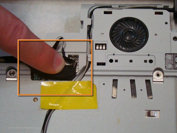

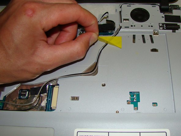

    9. Sony Vaio VGN-FS640 LCD Screen Replacement: crwdns2935265:027crwdnd2935265:01crwdnd2935265:03crwdne2935265:0 Sony Vaio VGN-FS640 LCD Screen Replacement: crwdns2935265:027crwdnd2935265:02crwdnd2935265:03crwdne2935265:0 Sony Vaio VGN-FS640 LCD Screen Replacement: crwdns2935265:027crwdnd2935265:03crwdnd2935265:03crwdne2935265:0
      • Place the power and display cables for the new screen into their respective grooves.
      • It may help to use a spudger to push the cables into the grooves.
      • Place the two pieces of tape back over the display cables.

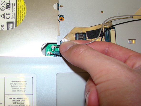

    10. Sony Vaio VGN-FS640 LCD Screen Replacement: crwdns2935265:028crwdnd2935265:01crwdnd2935265:03crwdne2935265:0 Sony Vaio VGN-FS640 LCD Screen Replacement: crwdns2935265:028crwdnd2935265:02crwdnd2935265:03crwdne2935265:0 Sony Vaio VGN-FS640 LCD Screen Replacement: crwdns2935265:028crwdnd2935265:03crwdnd2935265:03crwdne2935265:0
      • Once the new screen and its cables are securely in place, attach the three cables to their corresponding ports.
      • For each cable, place the connector on top of the port and align the two as close as possible.
      • To connect the power cable, use your finger to push downward on the middle of the connector until it snaps into place.
      • To connect each display cable, use the flat end of a spudger to press on the top of the silver connector until it snaps into place.
      • Snapping the connectors into place does require a little bit of force, but be careful, too much force can break the motherboard. If the connector doesn't snap into place with a moderate amount of force, realign it and try again.
      • Make sure the two display cables are connected to the correct ports. The grey cable should connect closest to the screen.
