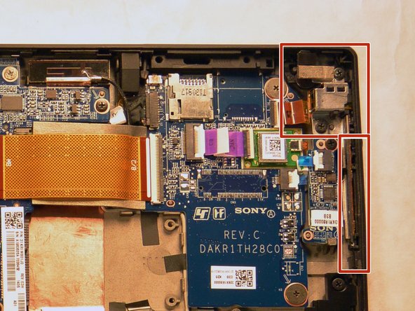

  4. Sony Vaio Tap 11 Audio Jack Replacement, Audio Jack: crwdns2935265:04crwdnd2935265:01crwdnd2935265:01crwdne2935265:0
    • After removing the screen, disconnect the battery from the motherboard to avoid shock or the shorting of circuits.
  5. Sony Vaio Tap 11 Audio Jack Replacement: crwdns2935265:05crwdnd2935265:01crwdnd2935265:02crwdne2935265:0 Sony Vaio Tap 11 Audio Jack Replacement: crwdns2935265:05crwdnd2935265:02crwdnd2935265:02crwdne2935265:0
    • Once the battery is disconnected, locate the audio jack.

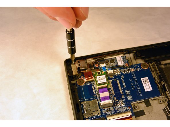

  6. Sony Vaio Tap 11 Audio Jack Replacement: crwdns2935265:06crwdnd2935265:01crwdnd2935265:02crwdne2935265:0 Sony Vaio Tap 11 Audio Jack Replacement: crwdns2935265:06crwdnd2935265:02crwdnd2935265:02crwdne2935265:0
    • Using the Phillips #000, remove the two 3 mm screws.

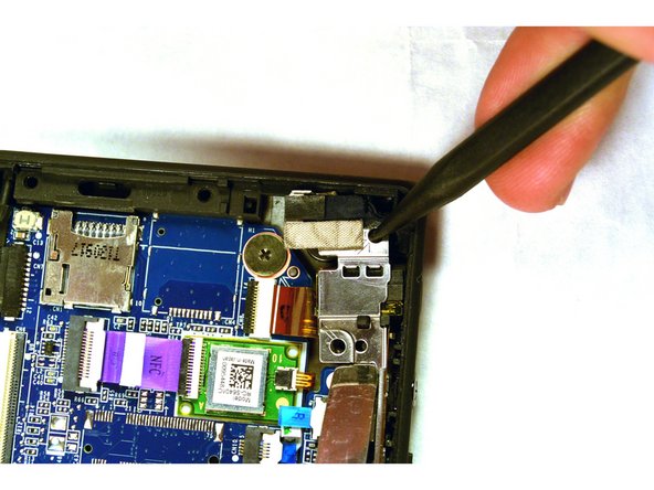

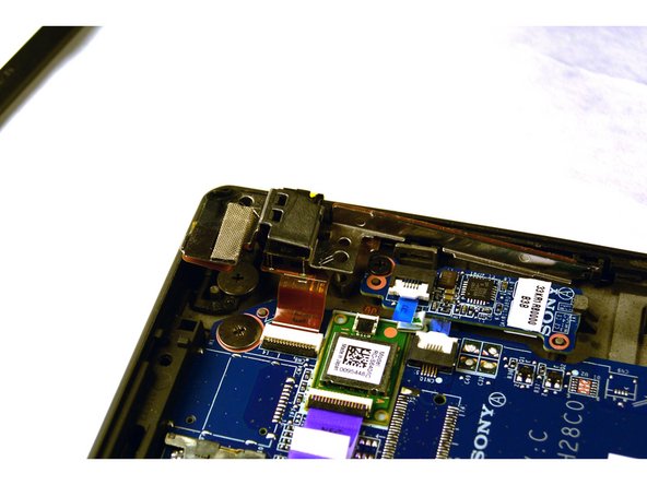

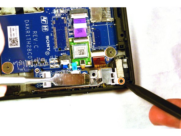

  7. Sony Vaio Tap 11 Audio Jack Replacement: crwdns2935265:07crwdnd2935265:01crwdnd2935265:03crwdne2935265:0 Sony Vaio Tap 11 Audio Jack Replacement: crwdns2935265:07crwdnd2935265:02crwdnd2935265:03crwdne2935265:0 Sony Vaio Tap 11 Audio Jack Replacement: crwdns2935265:07crwdnd2935265:03crwdnd2935265:03crwdne2935265:0
    • With the screws removed, use a plastic opening tool to lightly pry the board up over a plastic positioning peg.
    • Though these images show a metal spudger, you should use plastic opening tools to avoid damage.
    • Insert the tip of a spudger where the upper screw was located and push the board inward while prying up with the plastic opening tool.
    • Lightly pry with the opening tool, enough for the board to lift off the positioning peg and then push inward with the spudger. The board should begin to separate from the corner.

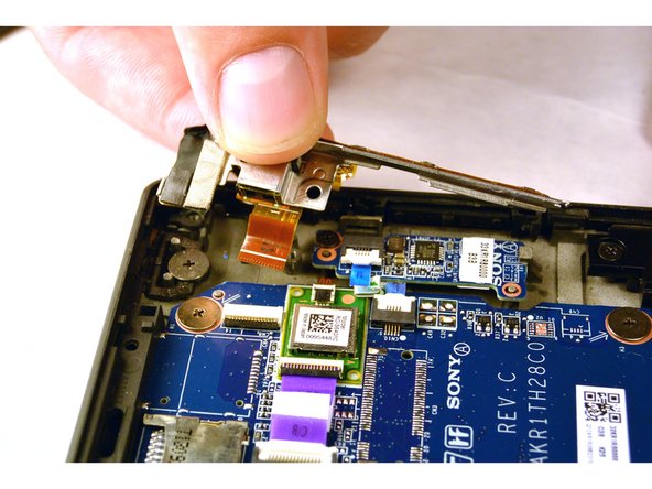

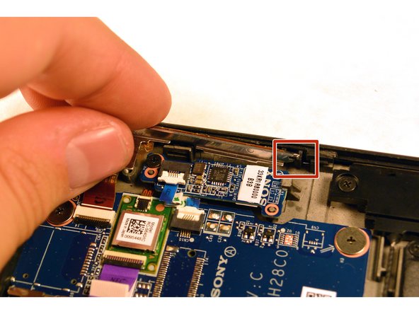

  8. Sony Vaio Tap 11 Audio Jack Replacement: crwdns2935265:08crwdnd2935265:01crwdnd2935265:03crwdne2935265:0 Sony Vaio Tap 11 Audio Jack Replacement: crwdns2935265:08crwdnd2935265:02crwdnd2935265:03crwdne2935265:0 Sony Vaio Tap 11 Audio Jack Replacement: crwdns2935265:08crwdnd2935265:03crwdnd2935265:03crwdne2935265:0
    • If Step 4 was done correctly, the board should dislodge from the corner mold.
    • Remove the rest of the board by pulling it up and out.
    • Pull the small narrow end of the board horizontally towards the corner, freeing the board from the panel with the exception of the connector.
  9. Sony Vaio Tap 11 Audio Jack Replacement: crwdns2935265:09crwdnd2935265:01crwdnd2935265:02crwdne2935265:0 Sony Vaio Tap 11 Audio Jack Replacement: crwdns2935265:09crwdnd2935265:02crwdnd2935265:02crwdne2935265:0
    • Disconnect the audio jack connector and remove the entire audio jack power volume button board assembly.
