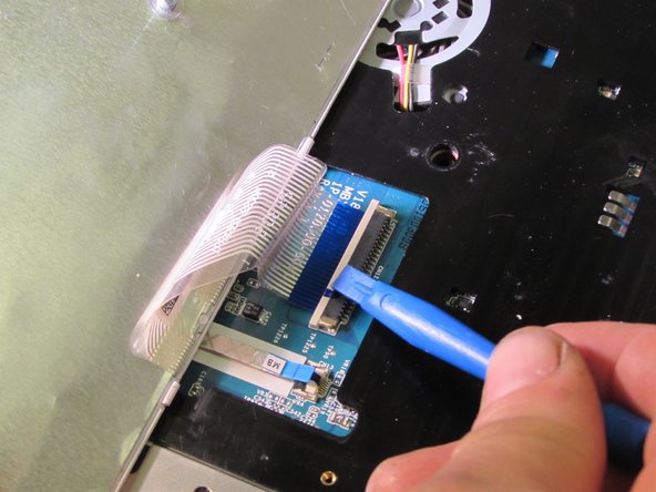

  7. Sony Vaio SVE111B11L Motherboard Replacement: crwdns2935265:07crwdnd2935265:01crwdnd2935265:03crwdne2935265:0 Sony Vaio SVE111B11L Motherboard Replacement: crwdns2935265:07crwdnd2935265:02crwdnd2935265:03crwdne2935265:0 Sony Vaio SVE111B11L Motherboard Replacement: crwdns2935265:07crwdnd2935265:03crwdnd2935265:03crwdne2935265:0
    • Gently pry the keyboard assembly from the screen side, using an opening tool. You will need to lift the keyboard about two inches.
    • Using an opening tool, gently pull out and slightly up on the connector clip.
    • Gently lift the keyboard assembly up and out.

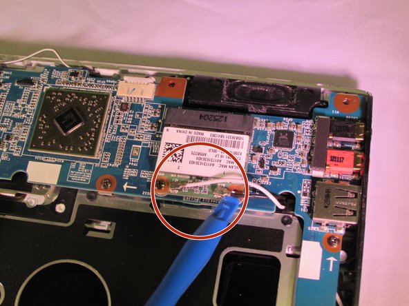

  8. Sony Vaio SVE111B11L Motherboard Replacement, Fan: crwdns2935265:08crwdnd2935265:01crwdnd2935265:01crwdne2935265:0
    • Locate the fan and heat-sink.
  9. Sony Vaio SVE111B11L Motherboard Replacement: crwdns2935265:09crwdnd2935265:01crwdnd2935265:01crwdne2935265:0
    • Locate the wires and connectors, and gently unplug them.
  10. Sony Vaio SVE111B11L Motherboard Replacement: crwdns2935265:010crwdnd2935265:01crwdnd2935265:01crwdne2935265:0
    • Locate and remove the 6.7 mm screws that hold the fan assembly.
  11. Sony Vaio SVE111B11L Motherboard Replacement: crwdns2935265:011crwdnd2935265:01crwdnd2935265:01crwdne2935265:0
    • Gently lift the fan assembly up and out.

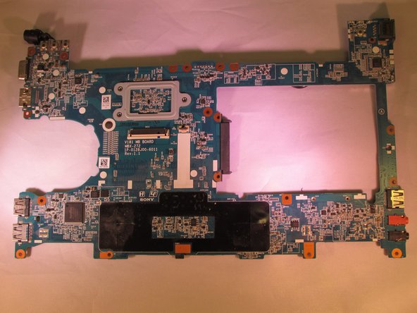

  13. Sony Vaio SVE111B11L Motherboard Replacement: crwdns2935265:013crwdnd2935265:01crwdnd2935265:01crwdne2935265:0
    • Locate and remove the screws holding the motherboard down.
    • Screws: L 4.6mm X D 1.85mm

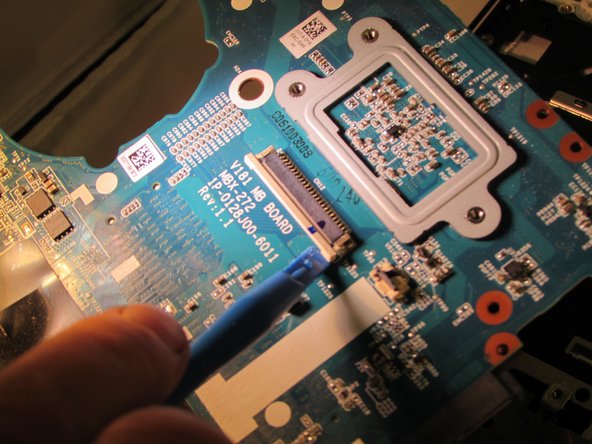

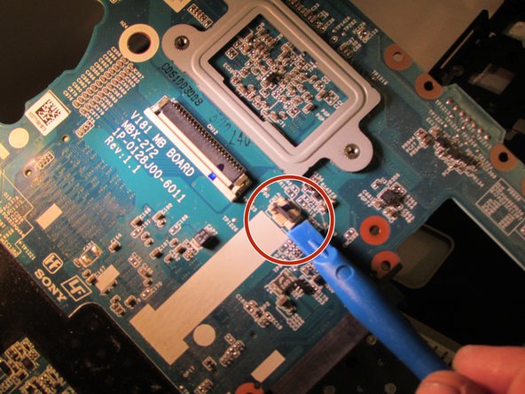

  14. Sony Vaio SVE111B11L Motherboard Replacement: crwdns2935265:014crwdnd2935265:01crwdnd2935265:03crwdne2935265:0 Sony Vaio SVE111B11L Motherboard Replacement: crwdns2935265:014crwdnd2935265:02crwdnd2935265:03crwdne2935265:0 Sony Vaio SVE111B11L Motherboard Replacement: crwdns2935265:014crwdnd2935265:03crwdnd2935265:03crwdne2935265:0
    • Locate the wires and connectors and remove them from the motherboard.
  15. Sony Vaio SVE111B11L Motherboard Replacement: crwdns2935265:015crwdnd2935265:01crwdnd2935265:02crwdne2935265:0 Sony Vaio SVE111B11L Motherboard Replacement: crwdns2935265:015crwdnd2935265:02crwdnd2935265:02crwdne2935265:0
    • Lift the mother board out and safely put it to the side.
