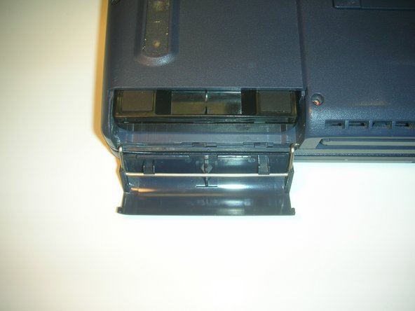

  4. Sony Vaio PCG-981L Battery Replacement: crwdns2935265:04crwdnd2935265:01crwdnd2935265:01crwdne2935265:0
    • To remove the battery cover, use your hands to slide it upwards.
  5. Sony Vaio PCG-981L Battery Replacement: crwdns2935265:05crwdnd2935265:01crwdnd2935265:03crwdne2935265:0 Sony Vaio PCG-981L Battery Replacement: crwdns2935265:05crwdnd2935265:02crwdnd2935265:03crwdne2935265:0 Sony Vaio PCG-981L Battery Replacement: crwdns2935265:05crwdnd2935265:03crwdnd2935265:03crwdne2935265:0

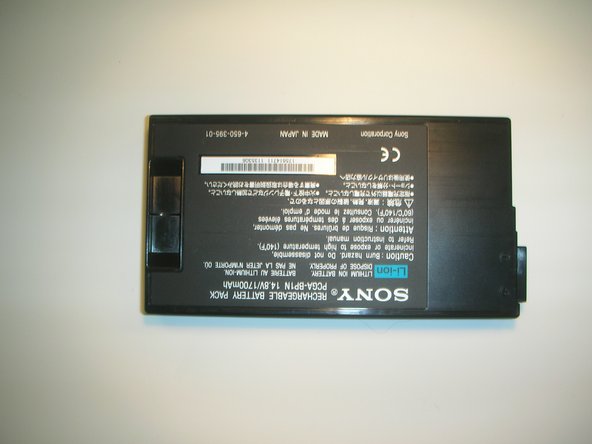

    • Once lifted, the battery cover should flip open.
    • Now, carefully remove the battery from the device.
  6. Sony Vaio PCG-981L Battery Replacement: crwdns2935265:06crwdnd2935265:01crwdnd2935265:02crwdne2935265:0 Sony Vaio PCG-981L Battery Replacement: crwdns2935265:06crwdnd2935265:02crwdnd2935265:02crwdne2935265:0
    • Now, the battery should be completely removed from the device.
    • Be sure to dispose of the old battery properly and then you are finished.
