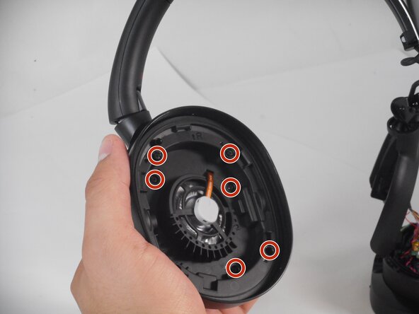

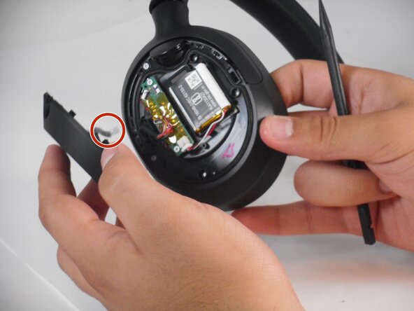

    • Remove the right ear pad by gently prying it open with the spudger.

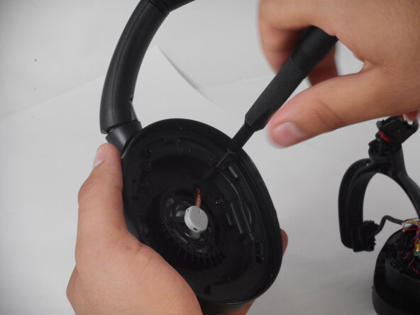

    • Remove the eight 4.3 mm screws on the driver.

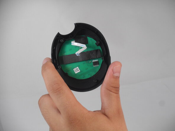

    • Flip over the right ear pad to expose the outer shell.
    • Carefully pry the outer shell with the plastic spudger, making sure to keep the ribbon cable intact.
    • Disconnect the ribbon cable from the board.
    • The sensor is attached to the outer shell, from here the sensor can be replaced.
