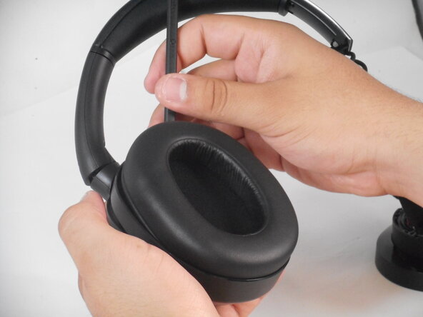

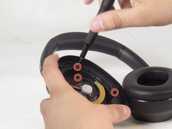

    • Remove the affected driver's ear pad from the can to reveal 8 8.2 mm screws.
    • If you're replacing the I/O board, remove the left ear pad.
    • Unscrew all eight Phillips #00 screws from the driver housing.

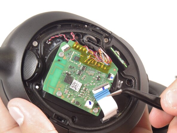

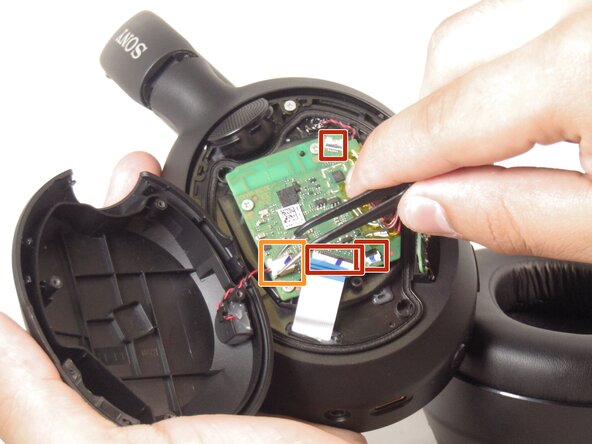

    • Flip the can upside down, so the top of the PCB is facing upwards.
    • Flip up the three black ZIF locking flaps and disconnect each of the three ribbon cables with tweezers.
    • Grip and pull the white connector directly out of its socket.

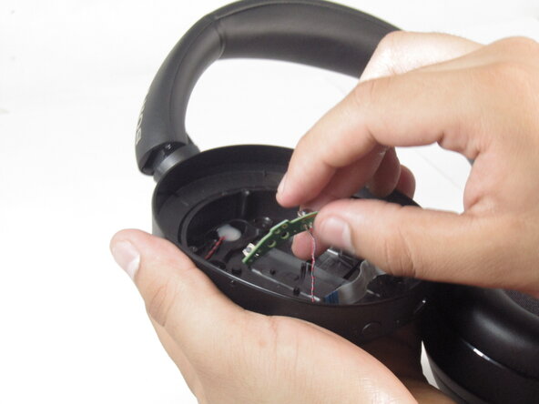

    • Flip the can so that the back of the PCB is visible.
    • Disconnect the white ribbon cable.
    • Remove the PCB from the housing.

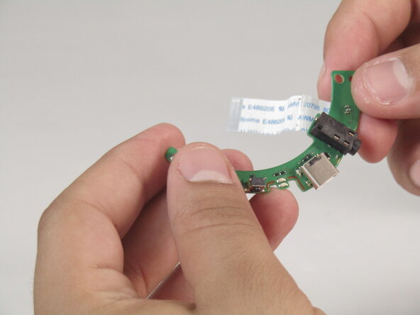

    • There is a secondary board soldered to the PCB. Detach this board by carefully pulling it off with your fingers.
    • Lift and pull the PCB to remove it carefully, while making sure not to damage the ribbon cable.
    • The secondary PCB needs to be re-soldered.
