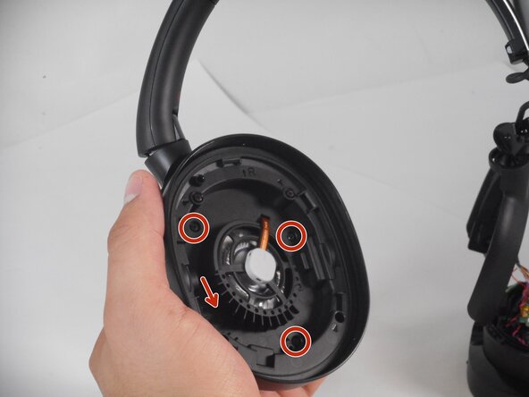

    • Remove the ear cushion carefully from the right can.

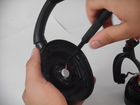

    • Only remove the four screws from the center of the can using a Phillips #00 screwdriver.

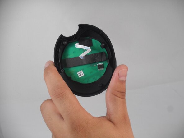

    • Flip the right cuff of the headphones so the can lays flat.

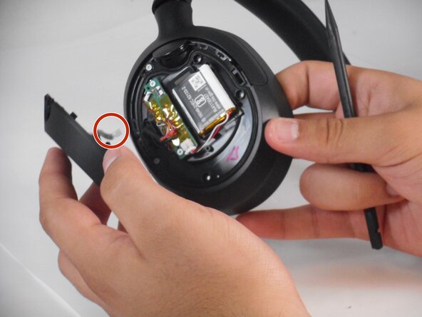

    • Take your spudger and carefully pry the cover off.
    • When removing the cover, do not pull roughly as this can damage the ribbon cable connecting the cover to the rest of the can.
    • Use your tweezers to lift the small black ZIF locking flap and disconnect the ribbon cable.

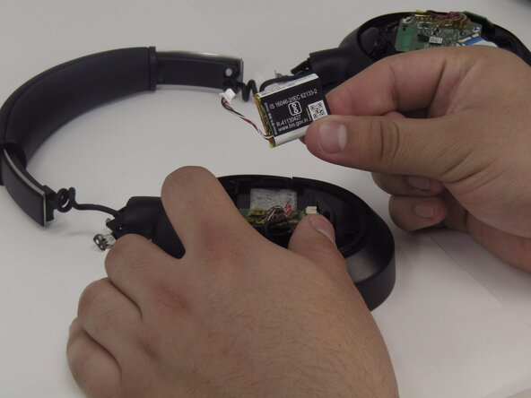

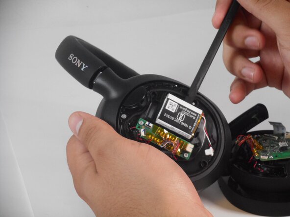

    • Use tweezers to pull the white battery connector directly out of its socket.
    • Use a hairdryer to lightly heat the battery.
    • Place the flat end of a spudger under the battery to pry it slowly off the adhesive.
    • Take care not to bend or puncture the battery.
