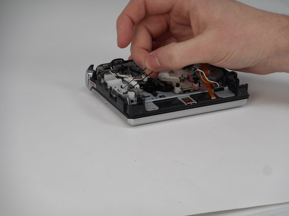

  8. Sony TCM-450 Belt (Counter) Replacement: crwdns2935265:08crwdnd2935265:01crwdnd2935265:01crwdne2935265:0
    • Lift the PCB from the device.
    • Make sure not to pull out any wires while lifting the board, as it could cause damage to the device.
  9. Sony TCM-450 Belt (Counter) Replacement, Belt for Counter: crwdns2935265:09crwdnd2935265:01crwdnd2935265:02crwdne2935265:0 Sony TCM-450 Belt (Counter) Replacement, Belt for Counter: crwdns2935265:09crwdnd2935265:02crwdnd2935265:02crwdne2935265:0
    • Remove the counter belt by pulling it gently out and away from the parts it connects to and away from the board.
    • Make sure that you do not pull the belt too hard, or it may snap back and hit you as it is made of rubber.
