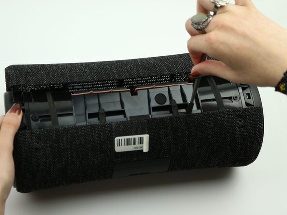

    • Before beginning, make sure to unplug and power off your speaker.
    • With the Sony label on the left, roll the speaker horizontally to the bottom of the speaker with the rubber stands.
    • Remove four 12 mm screws with a Phillips #1 screwdriver.
    • Remove the loose rubber feet.
  2. Sony SRS-XG300 Fabric Cover Replacement: crwdns2935265:02crwdnd2935265:01crwdnd2935265:02crwdne2935265:0 Sony SRS-XG300 Fabric Cover Replacement: crwdns2935265:02crwdnd2935265:02crwdnd2935265:02crwdne2935265:0
    • Insert the metal spudger tool at 90-degree angle into the right part of seam.
    • Pry off the top part of the fabric cover using the metal spudger.
    • Follow the seam to completely detach the top part of the fabric cover.
    • Repeat to remove the bottom part of the fabric cover.
