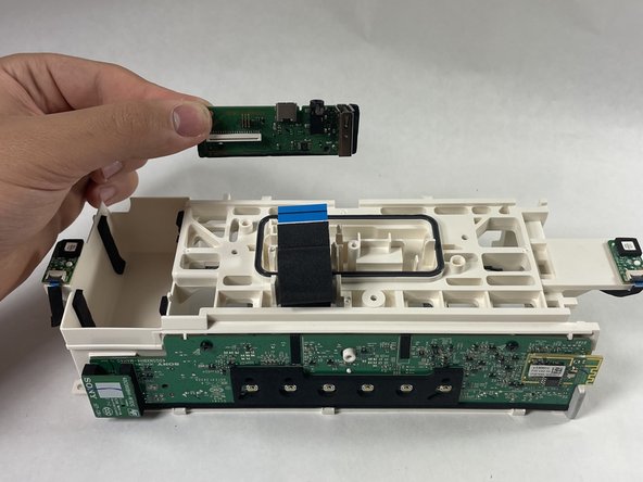

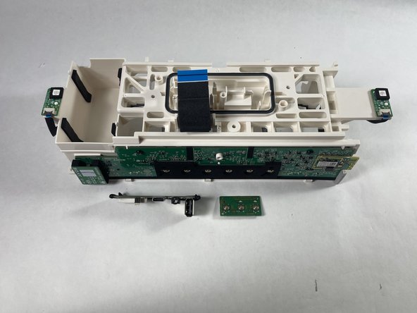

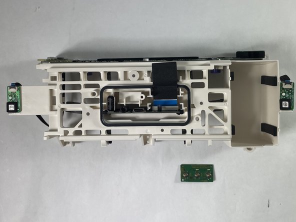

  9. Sony SRS-XB43 Port Housing PCB Replacement, Port Housing PCB: crwdns2935265:09crwdnd2935265:01crwdnd2935265:02crwdne2935265:0 Sony SRS-XB43 Port Housing PCB Replacement, Port Housing PCB: crwdns2935265:09crwdnd2935265:02crwdnd2935265:02crwdne2935265:0
    • Orient the motherboard chassis so that the battery compartment is facing upwards.
    • Remove the button PCB by grabbing it by its sides and gently pulling it upwards.

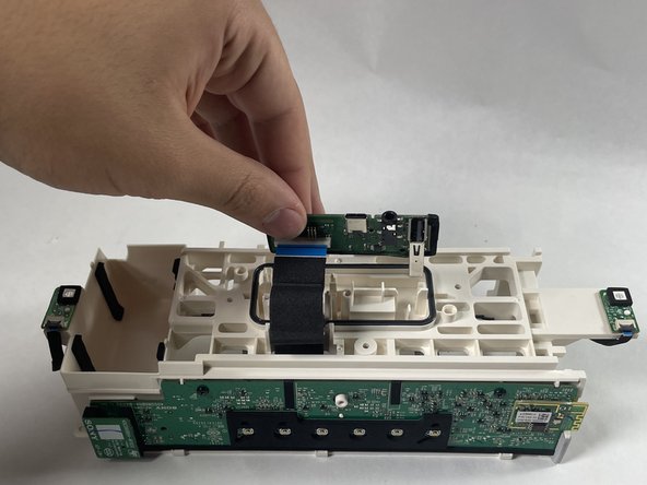

  10. Sony SRS-XB43 Port Housing PCB Replacement: crwdns2935265:010crwdnd2935265:01crwdnd2935265:02crwdne2935265:0 Sony SRS-XB43 Port Housing PCB Replacement: crwdns2935265:010crwdnd2935265:02crwdnd2935265:02crwdne2935265:0
    • Grab the port housing PCB and gently pull it upward to remove it from the chassis.
    • To the very left of the PCB, right next to the six metal pins facing upwards, is an empty space big enough to get a firm grip on the circuit board with your fingers which will help while removing it.
  11. Sony SRS-XB43 Port Housing PCB Replacement: crwdns2935265:011crwdnd2935265:01crwdnd2935265:03crwdne2935265:0 Sony SRS-XB43 Port Housing PCB Replacement: crwdns2935265:011crwdnd2935265:02crwdnd2935265:03crwdne2935265:0 Sony SRS-XB43 Port Housing PCB Replacement: crwdns2935265:011crwdnd2935265:03crwdnd2935265:03crwdne2935265:0
    • Locate the black ribbon cable with the blue tip plugged into the port housing PCB.
    • To unplug the ribbon cable from the PCB, grab it from its base and apply a suitable amount of force towards yourself until it becomes loose and disconnects.
