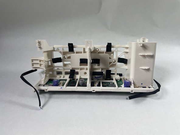

  5. Sony SRS-XB43 Motherboard Replacement, Battery: crwdns2935265:05crwdnd2935265:01crwdnd2935265:02crwdne2935265:0 Sony SRS-XB43 Motherboard Replacement, Battery: crwdns2935265:05crwdnd2935265:02crwdnd2935265:02crwdne2935265:0
    • Orient the speaker's backplate so that the plastic chassis and internal electronics are facing upwards.
    • Remove the eight 10 mm screws securing the motherboard chassis to the backplate using a Phillips #1 screwdriver.
    • Grab the motherboard chassis and gently remove it from the backplate of the speaker.
  6. Sony SRS-XB43 Motherboard Replacement: crwdns2935265:06crwdnd2935265:01crwdnd2935265:03crwdne2935265:0 Sony SRS-XB43 Motherboard Replacement: crwdns2935265:06crwdnd2935265:02crwdnd2935265:03crwdne2935265:0 Sony SRS-XB43 Motherboard Replacement: crwdns2935265:06crwdnd2935265:03crwdnd2935265:03crwdne2935265:0
    • Orient the motherboard chassis so that the side with the six buttons is facedown on the table and the opposite side is visible to you.
    • Disconnect the seven-prong cable (the one with red, yellow, and black wires) plugged into the motherboard by prying on its edge/extruding lip with a spudger.

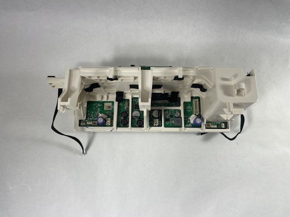

  9. Sony SRS-XB43 Motherboard Replacement, Motherboard: crwdns2935265:09crwdnd2935265:01crwdnd2935265:02crwdne2935265:0 Sony SRS-XB43 Motherboard Replacement, Motherboard: crwdns2935265:09crwdnd2935265:02crwdnd2935265:02crwdne2935265:0
    • Orient the motherboard chassis towards you for a clear view of connection points.
    • Disconnect both LED ribbon cables on the far right and left of the motherboard by gently pulling them up.
  10. Sony SRS-XB43 Motherboard Replacement: crwdns2935265:010crwdnd2935265:01crwdnd2935265:02crwdne2935265:0 Sony SRS-XB43 Motherboard Replacement: crwdns2935265:010crwdnd2935265:02crwdnd2935265:02crwdne2935265:0
    • Pull the port housing cable up from the middle-back edge of the motherboard.

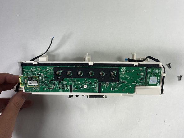

  11. Sony SRS-XB43 Motherboard Replacement: crwdns2935265:011crwdnd2935265:01crwdnd2935265:02crwdne2935265:0 Sony SRS-XB43 Motherboard Replacement: crwdns2935265:011crwdnd2935265:02crwdnd2935265:02crwdne2935265:0
    • Orient the chassis so that the back of the motherboard where the six buttons are located is facing upwards.
    • Remove the two 10 mm screws that secure the motherboard to its chassis using a Phillips #1 screwdriver.
  12. Sony SRS-XB43 Motherboard Replacement: crwdns2935265:012crwdnd2935265:01crwdnd2935265:02crwdne2935265:0 Sony SRS-XB43 Motherboard Replacement: crwdns2935265:012crwdnd2935265:02crwdnd2935265:02crwdne2935265:0
    • Gently remove the motherboard from the chassis.
