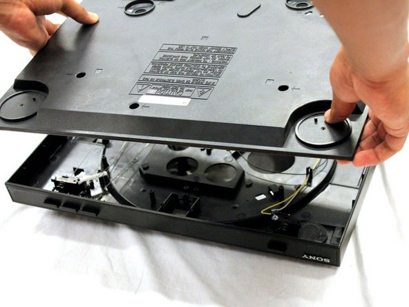

    • Use a PH2 screwdriver to remove the 8 screws from the bottom cover.
    • Now lift the bottom cover to remove it.
