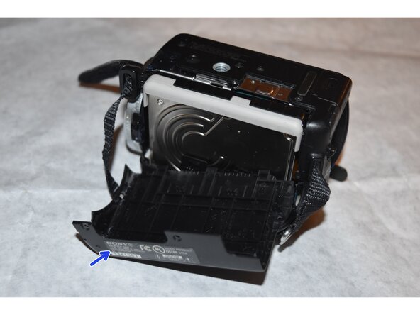

  4. Sony Handycam DCR-SR 47 Hard Drive Replacement: crwdns2935265:04crwdnd2935265:01crwdnd2935265:02crwdne2935265:0 Sony Handycam DCR-SR 47 Hard Drive Replacement: crwdns2935265:04crwdnd2935265:02crwdnd2935265:02crwdne2935265:0
    • Using a Phillips #000 screwdriver remove the single 3mm screw on the back of the camera.
    • Pull away the back shell of the camera to expose the hard drive.

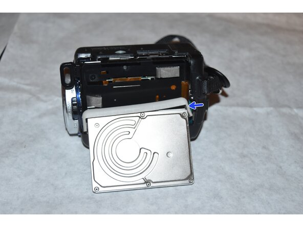

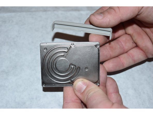

  5. Sony Handycam DCR-SR 47 Hard Drive Replacement: crwdns2935265:05crwdnd2935265:01crwdnd2935265:03crwdne2935265:0 Sony Handycam DCR-SR 47 Hard Drive Replacement: crwdns2935265:05crwdnd2935265:02crwdnd2935265:03crwdne2935265:0 Sony Handycam DCR-SR 47 Hard Drive Replacement: crwdns2935265:05crwdnd2935265:03crwdnd2935265:03crwdne2935265:0
    • Gently pull the flex cable away from the hard drive. It should pop off with minimal effort.
    • The black guard is removed in the first picture. While the guard is not necessary to access the hard drive and cable, removing it can be helpful to show the cable's path.
    • After removing the flex cable take off the plastic guard from the side of the hard drive.
