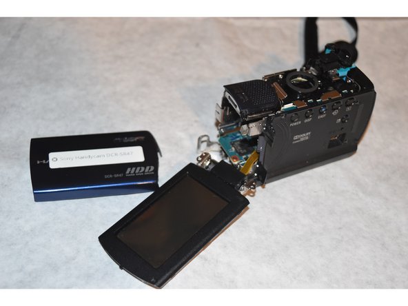

    • Remove the battery.
    • Use a Philips #000 screwdriver to remove the 3mm screw under the battery.
    • It is recommended that you wait one hour after removing the battery before disassembling the rest of the camera.

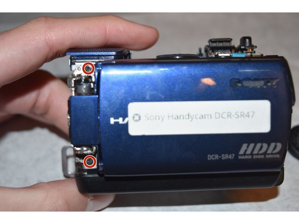

    • Using the Phillips #000 screwdriver, remove all six of the 3mm screws located on the side of the camera.
    • This step seems unnecessary to initially find the hard drive, but will allow access to the attached flex cable.

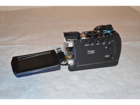

    • Using the Phillips #000 screwdriver remove the three 3mm screws from under the LCD screen.

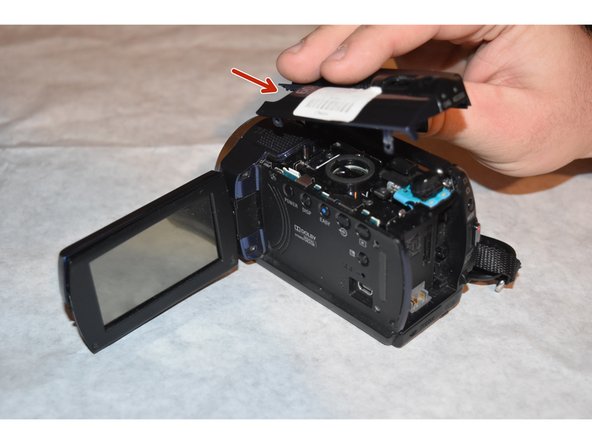

    • Using a Phillips #000 screwdriver remove the single 3mm screw on the back of the camera.
    • Pull away the back shell of the camera to expose the hard drive.
  5. Sony Handycam DCR-SR 47 Flex Cable Replacement: crwdns2935265:05crwdnd2935265:01crwdnd2935265:03crwdne2935265:0 Sony Handycam DCR-SR 47 Flex Cable Replacement: crwdns2935265:05crwdnd2935265:02crwdnd2935265:03crwdne2935265:0 Sony Handycam DCR-SR 47 Flex Cable Replacement: crwdns2935265:05crwdnd2935265:03crwdnd2935265:03crwdne2935265:0

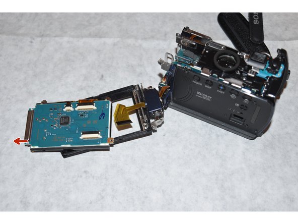

  7. Sony Handycam DCR-SR 47 Flex Cable Replacement: crwdns2935265:07crwdnd2935265:01crwdnd2935265:03crwdne2935265:0 Sony Handycam DCR-SR 47 Flex Cable Replacement: crwdns2935265:07crwdnd2935265:02crwdnd2935265:03crwdne2935265:0 Sony Handycam DCR-SR 47 Flex Cable Replacement: crwdns2935265:07crwdnd2935265:03crwdnd2935265:03crwdne2935265:0

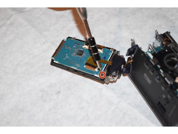

    • Using the Phillips #000 screwdriver, remove the two 3mm screws from the LCD Screen connector.
    • Remove the two 3mm screws that were exposed through the previous image
    • Carefully detach the LCD Screen from the rest of the camera.

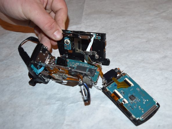

  13. Sony Handycam DCR-SR 47 Flex Cable Replacement: crwdns2935265:013crwdnd2935265:01crwdnd2935265:02crwdne2935265:0 Sony Handycam DCR-SR 47 Flex Cable Replacement: crwdns2935265:013crwdnd2935265:02crwdnd2935265:02crwdne2935265:0
    • Using the Phillips #000 screwdriver, remove the one 3mm screw from the speaker port
    • Detach the speaker and side of camera from the internal components

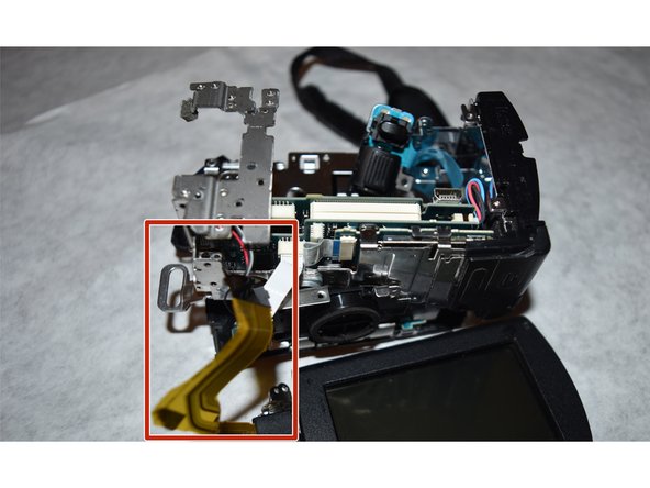

  14. Sony Handycam DCR-SR 47 Flex Cable Replacement: crwdns2935265:014crwdnd2935265:01crwdnd2935265:02crwdne2935265:0 Sony Handycam DCR-SR 47 Flex Cable Replacement: crwdns2935265:014crwdnd2935265:02crwdnd2935265:02crwdne2935265:0
    • Gently pull the flex cable out of the connector piece.
    • How it should look after cable is out of the connector piece.
    • *a spudger may be used if necessary*

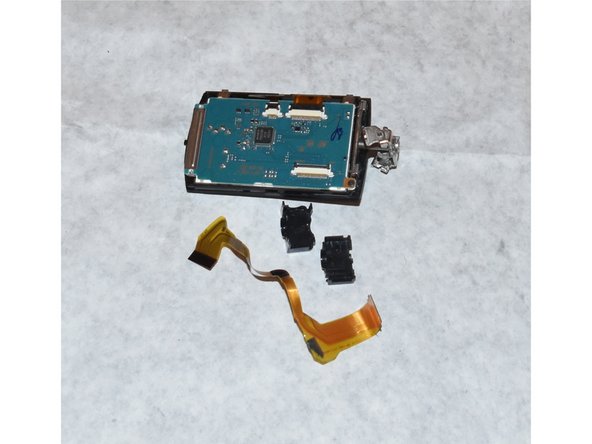

  15. Sony Handycam DCR-SR 47 Flex Cable Replacement: crwdns2935265:015crwdnd2935265:01crwdnd2935265:02crwdne2935265:0 Sony Handycam DCR-SR 47 Flex Cable Replacement: crwdns2935265:015crwdnd2935265:02crwdnd2935265:02crwdne2935265:0
    • After removing the flex cable from the internal components, separate the LCD pivot arm housing from the flex cable using a spudger.
    • The old flex cable is now free and able to be switched with the new one.
