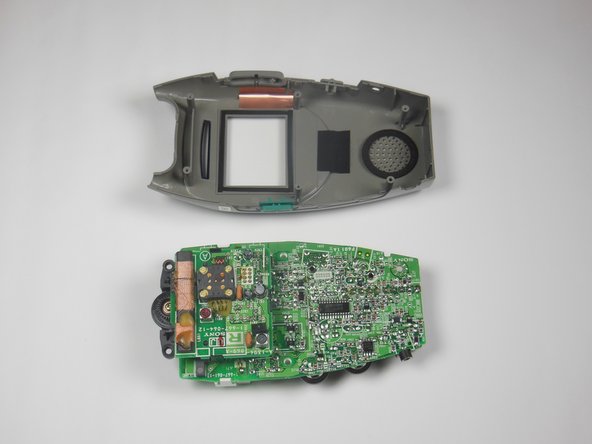

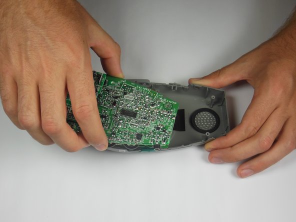

  4. Sony FDL-220R Watchman Speaker Replacement, Remove circuit board: crwdns2935265:04crwdnd2935265:01crwdnd2935265:03crwdne2935265:0 Sony FDL-220R Watchman Speaker Replacement, Remove circuit board: crwdns2935265:04crwdnd2935265:02crwdnd2935265:03crwdne2935265:0 Sony FDL-220R Watchman Speaker Replacement, Remove circuit board: crwdns2935265:04crwdnd2935265:03crwdnd2935265:03crwdne2935265:0
    • Carefully grasp the entire circuit board.
    • Pull the circuit board off of the device's plastic casing.
  5. Sony FDL-220R Watchman Speaker Replacement, Remove speaker: crwdns2935265:05crwdnd2935265:01crwdnd2935265:03crwdne2935265:0 Sony FDL-220R Watchman Speaker Replacement, Remove speaker: crwdns2935265:05crwdnd2935265:02crwdnd2935265:03crwdne2935265:0 Sony FDL-220R Watchman Speaker Replacement, Remove speaker: crwdns2935265:05crwdnd2935265:03crwdnd2935265:03crwdne2935265:0
    • Locate the mono-speaker on the device.
    • Locate the two through-hole contacts to the right of the speaker.
    • Touch a soldering iron to the two through-hole contacts.
    • While the solder is hot, pull down on the wire with tweezers.
    • It may be helpful to remove excess solder with a solder wick or sucker.
