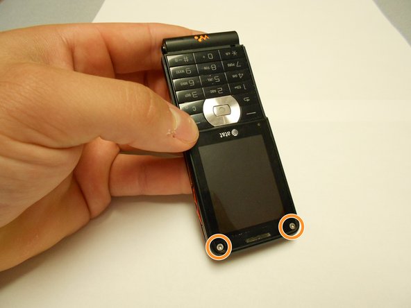

    • Flip the phone over and remove the Sony Ericsson sticker that is over the phone's ear speaker.
    • Using a T5 screwdriver, loosen and remove the two screws under the Sony Ericsson sticker by turning them counterclockwise.

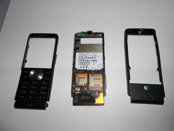

    • Insert an opening tool in the bottom crack between the front and back plates and use a gentle upward pull to separate the back case from the front case.
    • Side buttons/controls may fall from their place in between the back and front casings.

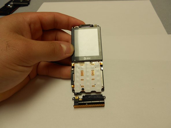

    • Using an opening tool and a gentle outward motion, separate the front plate from the inner phone workings.
  8. Sony Ericsson W350a Speaker Replacement: crwdns2935265:08crwdnd2935265:01crwdnd2935265:02crwdne2935265:0 Sony Ericsson W350a Speaker Replacement: crwdns2935265:08crwdnd2935265:02crwdnd2935265:02crwdne2935265:0
    • Using a Phillips head screwdriver, remove the screw from the front number pad by turning it counterclockwise.
    • Remove the speaker from the phone.
