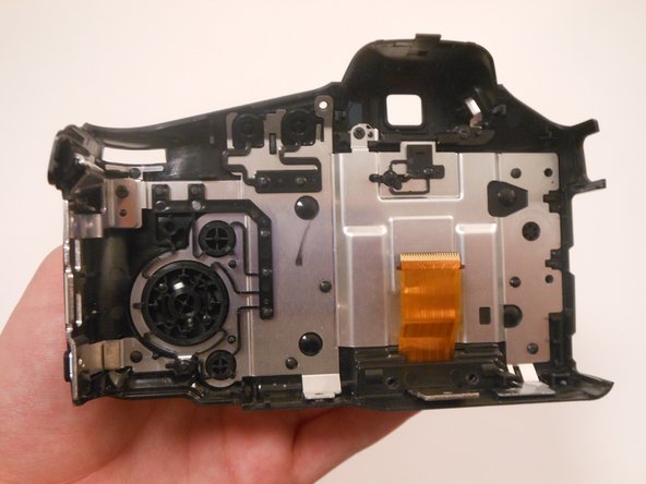

    • Open the back panel to view the inside of the camera.
    • Gently pull the orange ribbon cable to separate the two parts of the camera.
    • Set the front part of the camera to the side.

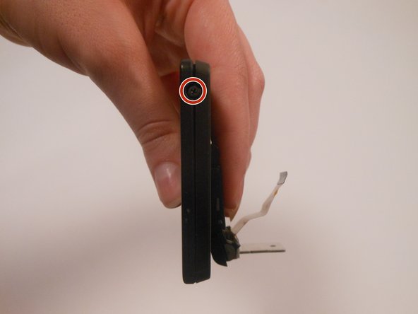

    • Turn the screen so that the side with the screw is facing you.
    • Remove the 1.59mm #00 screw with the Phillips #00 screwdriver.
  7. Sony Cyber-shot DSC-HX100V  LCD Screen Replacement: crwdns2935265:07crwdnd2935265:01crwdnd2935265:01crwdne2935265:0
    • Flip the screen over to view the backside.
    • Use a Phillips #00 screwdriver to remove the 1.59mm #00 screw.

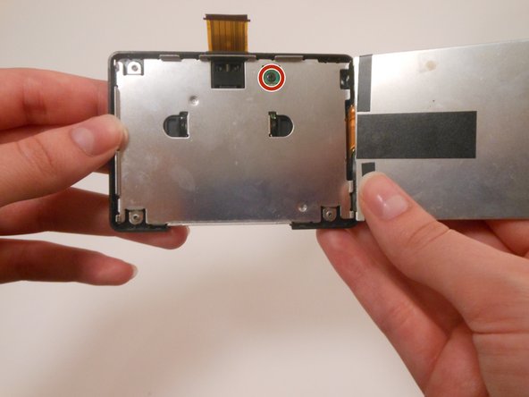

    • Lift the screen upwards to view the inside.
    • Use the Phillips screwdriver size #00 to remove the 1.59mm screw inside the green square.

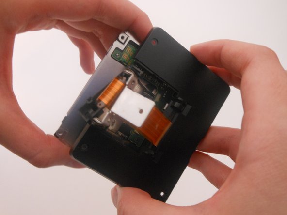

  13. Sony Cyber-shot DSC-HX100V  LCD Screen Replacement: crwdns2935265:013crwdnd2935265:01crwdnd2935265:02crwdne2935265:0 Sony Cyber-shot DSC-HX100V  LCD Screen Replacement: crwdns2935265:013crwdnd2935265:02crwdnd2935265:02crwdne2935265:0
    • Using a Phillips #00 screwdriver, remove the three 1.59mm #00 screws from the back panel.
    • Lift up the black panel on the backside to remove.

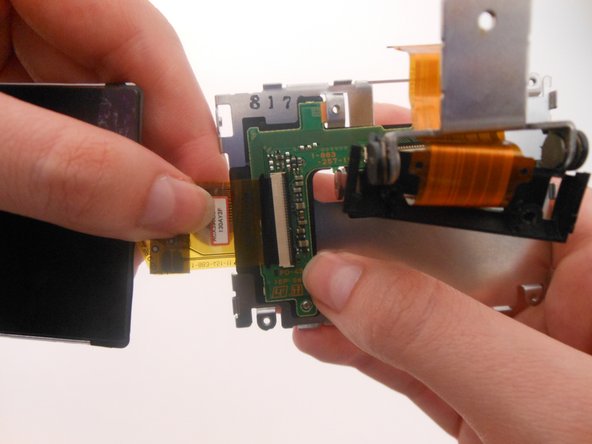

    • Lift the entire screen upwards.
    • Gently tug the orange ribbon cable to remove the screen from the silver panel.
