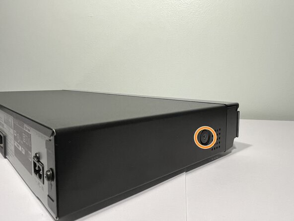

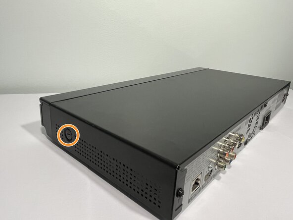

    • Use a Phillips #1 screwdriver to remove the screws from the back and sides of the device that hold the Blu-ray player’s outer casing in place.
    • Three 8.3 mm-long screws on the back of the device
    • Two 12 mm-long screws—one from each side of the device
  3. Sony BDP-S360 Optical Disk Drive Replacement: crwdns2935265:03crwdnd2935265:01crwdnd2935265:02crwdne2935265:0 Sony BDP-S360 Optical Disk Drive Replacement: crwdns2935265:03crwdnd2935265:02crwdnd2935265:02crwdne2935265:0
    • Slide the cover toward the back of the device to remove it.

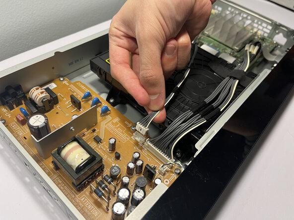

    • Use your fingers to squeeze the tab against the connector and pull straight up to disconnect the power cables from the board.
    • Don't pull on the cables as this may damage them or the connector.
    • To reconnect, push the connector over the socket until the clip engages. You'll hear and feel a distinct "click."

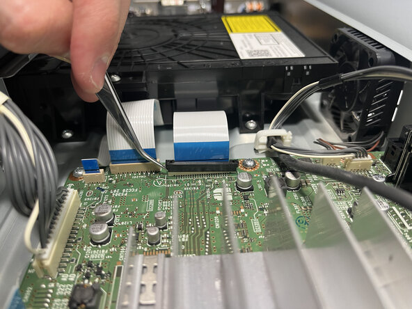

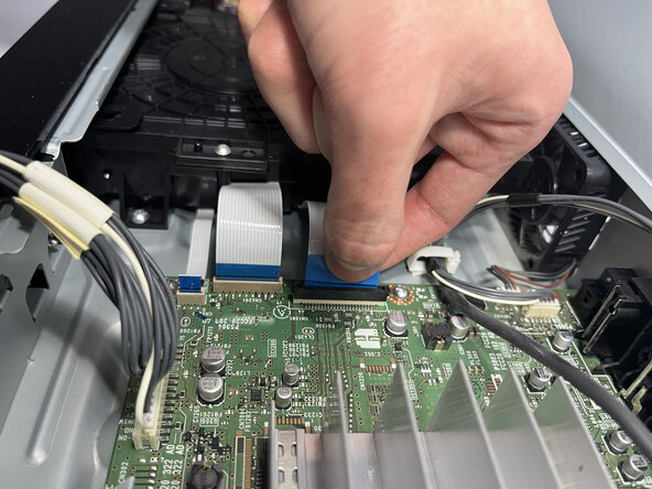

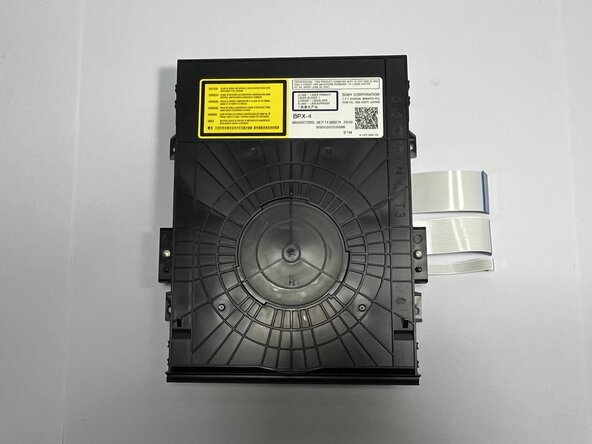

    • Use tweezers to pinch the blue tabs and gently pull out the two ribbon cables connected to the right of the optical disk drive.
    • To reconnect the cable, hold it as close to the end as possible and insert it back into the connector. Apply force to the plastic reinforcement rather than the cable itself.
    • Try not to kink or crease the cable.
    • Use a spudger or tweezers and gently push up on alternating sides of the black locking tab connector connected to the widest ribbon cable before attempting to pull out the cable.
    • Don't push the tab too hard or too far, otherwise it may come completely off the connector.
    • The ribbon cables are delicate and can be damaged if gripped directly.
    • During reassembly, insert the cable into its socket and use the flat end of a spudger to push the tab down into its locked position.
  6. Sony BDP-S360 Optical Disk Drive Replacement: crwdns2935265:06crwdnd2935265:01crwdnd2935265:02crwdne2935265:0 Sony BDP-S360 Optical Disk Drive Replacement: crwdns2935265:06crwdnd2935265:02crwdnd2935265:02crwdne2935265:0

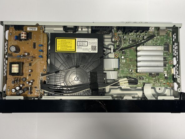

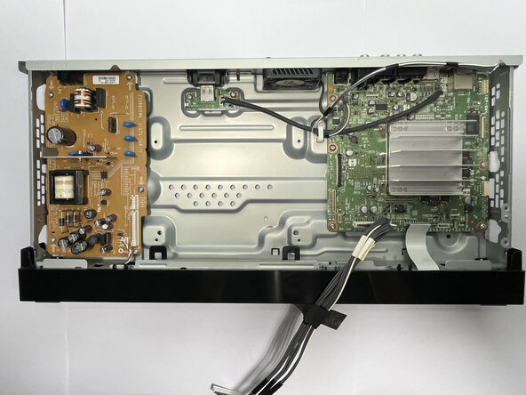

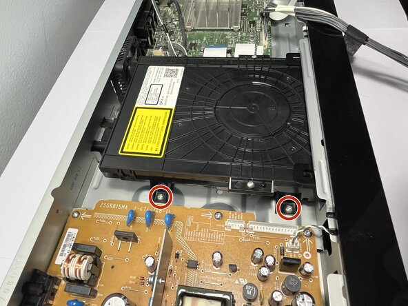

    • Use a Phillips #1 screwdriver to remove the four 7 mm screws near the corners of the component that secure the optical disc drive to the device frame.
  7. Sony BDP-S360 Optical Disk Drive Replacement: crwdns2935265:07crwdnd2935265:01crwdnd2935265:03crwdne2935265:0 Sony BDP-S360 Optical Disk Drive Replacement: crwdns2935265:07crwdnd2935265:02crwdnd2935265:03crwdne2935265:0 Sony BDP-S360 Optical Disk Drive Replacement: crwdns2935265:07crwdnd2935265:03crwdnd2935265:03crwdne2935265:0
    • Lift the optical disc drive at a 30-degree angle, then pull it out of the housing to remove it.
To reassemble your device, follow these instructions in reverse order. Take your e-waste to an R2 or e-Stewards certified recycler.
