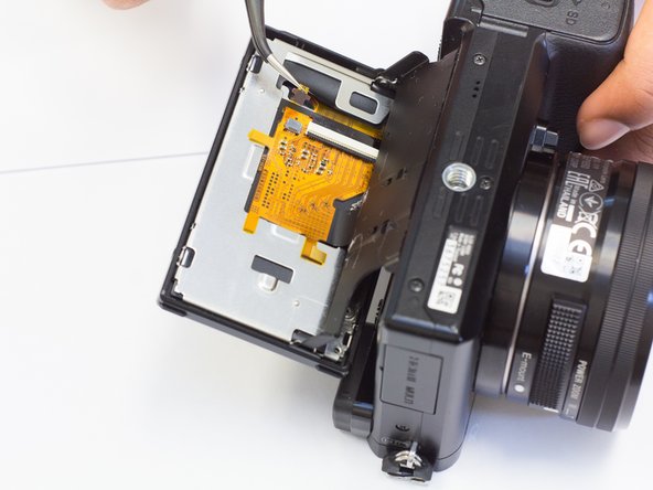

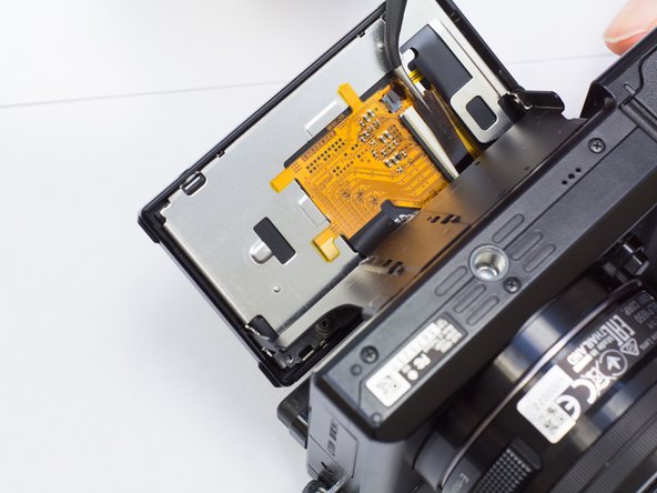

    • Flip the camera so that it is bottom side up. Pry off the inner support plate.
  10. Sony Alpha ILCE-6000 Screen Replacement: crwdns2935265:010crwdnd2935265:01crwdnd2935265:03crwdne2935265:0 Sony Alpha ILCE-6000 Screen Replacement: crwdns2935265:010crwdnd2935265:02crwdnd2935265:03crwdne2935265:0 Sony Alpha ILCE-6000 Screen Replacement: crwdns2935265:010crwdnd2935265:03crwdnd2935265:03crwdne2935265:0
    • Gently wiggle the screen's ribbon cable until it comes free from the white slot.
  11. Sony Alpha ILCE-6000 Screen Replacement: crwdns2935265:011crwdnd2935265:01crwdnd2935265:01crwdne2935265:0
    • Pry apart the metal backplate and remove it.
  12. Sony Alpha ILCE-6000 Screen Replacement: crwdns2935265:012crwdnd2935265:01crwdnd2935265:02crwdne2935265:0 Sony Alpha ILCE-6000 Screen Replacement: crwdns2935265:012crwdnd2935265:02crwdnd2935265:02crwdne2935265:0
    • Gently remove the old screen, and replace it with the new one.

The white connector opens by prying up the black part. What about the little black connector?
Christopher St.Louis - crwdns2934203:0crwdne2934203:0
Just comes out when you pull on it gently
Kevin Ketelaars -
Top left screw on back plate is a pain to put back in at an angle with magnetized JIS driver. Non magnetized or slightly loose fitting driver might help.
Trick is to get the screw fit in the thread at the right angle, then drive it in with the driver at an angle.
