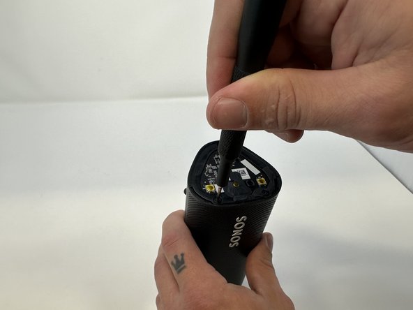

  3. Sonos Roam Inner Circuit Board Replacement, Speaker Grille: crwdns2935265:03crwdnd2935265:01crwdnd2935265:02crwdne2935265:0 Sonos Roam Inner Circuit Board Replacement, Speaker Grille: crwdns2935265:03crwdnd2935265:02crwdnd2935265:02crwdne2935265:0
    • Flip the device so that the Sonos logo is on the top.
    • Use the Torx T6 screwdriver to remove the two 6 mm screws.

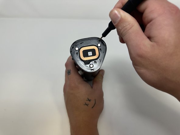

    • Flip the device.

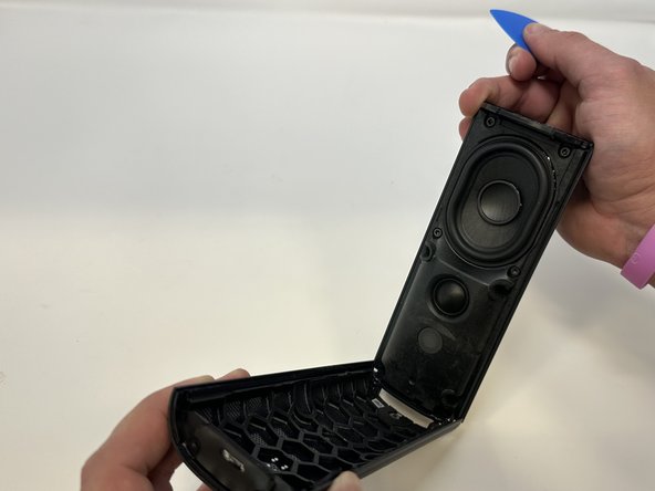

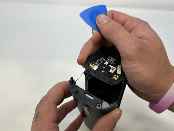

    • Flip the device so the Sonos logo is on the top.
    • Use the iFixit opening picks to wedge between the split of the grille and the back of the speaker to pry the grille apart.
    • Use the iOpener, a blowdryer, or a similar heating device to loosen the adhesive if having difficulty.

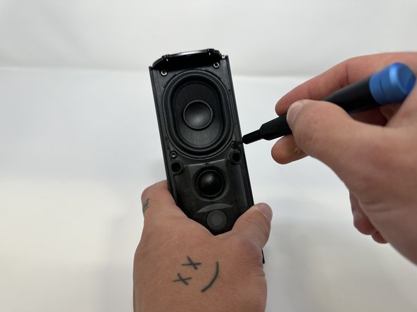

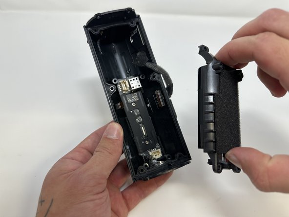

  6. Sonos Roam Inner Circuit Board Replacement, Speaker Module: crwdns2935265:06crwdnd2935265:01crwdnd2935265:02crwdne2935265:0 Sonos Roam Inner Circuit Board Replacement, Speaker Module: crwdns2935265:06crwdnd2935265:02crwdnd2935265:02crwdne2935265:0
    • Use the TR10 Torx screwdriver to remove the six 7 mm screws.

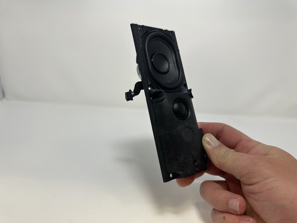

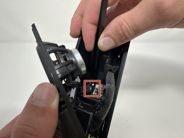

  7. Sonos Roam Inner Circuit Board Replacement: crwdns2935265:07crwdnd2935265:01crwdnd2935265:03crwdne2935265:0 Sonos Roam Inner Circuit Board Replacement: crwdns2935265:07crwdnd2935265:02crwdnd2935265:03crwdne2935265:0 Sonos Roam Inner Circuit Board Replacement: crwdns2935265:07crwdnd2935265:03crwdnd2935265:03crwdne2935265:0
    • Begin to carefully separate the speaker module from the device.
    • Firmly squeeze the middle of the plug using the tweezers to pull it out of the socket.
    • Separate the speaker module from the device.

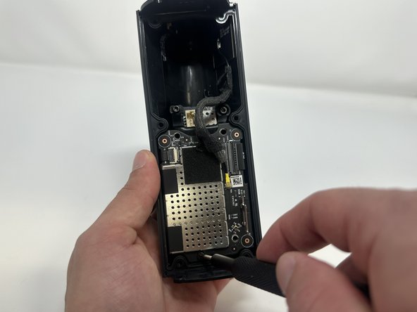

  8. Sonos Roam Inner Circuit Board Replacement, Outer Circuit Board: crwdns2935265:08crwdnd2935265:01crwdnd2935265:02crwdne2935265:0 Sonos Roam Inner Circuit Board Replacement, Outer Circuit Board: crwdns2935265:08crwdnd2935265:02crwdnd2935265:02crwdne2935265:0
    • Use the TR10 Torx screwdriver to remove the four 7 mm screws.

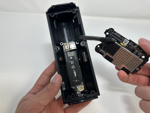

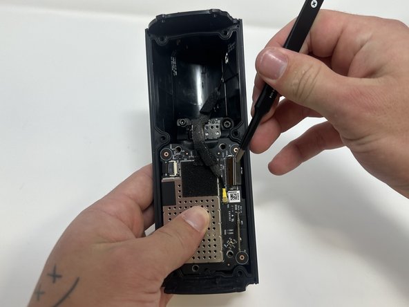

  9. Sonos Roam Inner Circuit Board Replacement: crwdns2935265:09crwdnd2935265:01crwdnd2935265:03crwdne2935265:0 Sonos Roam Inner Circuit Board Replacement: crwdns2935265:09crwdnd2935265:02crwdnd2935265:03crwdne2935265:0 Sonos Roam Inner Circuit Board Replacement: crwdns2935265:09crwdnd2935265:03crwdnd2935265:03crwdne2935265:0
    • Use the tweezers to flip the latch holding the large ribbon in place.
    • Grab the large ribbon with the tweezers and pull upwards to remove it.
    • Use the tweezers to flip the latch holding the small ribbon in place.
    • Grab the small ribbon with the tweezers and pull upwards to remove it.
  10. Sonos Roam Inner Circuit Board Replacement: crwdns2935265:010crwdnd2935265:01crwdnd2935265:03crwdne2935265:0 Sonos Roam Inner Circuit Board Replacement: crwdns2935265:010crwdnd2935265:02crwdnd2935265:03crwdne2935265:0 Sonos Roam Inner Circuit Board Replacement: crwdns2935265:010crwdnd2935265:03crwdnd2935265:03crwdne2935265:0
    • Grab the metal piece sticking out of the outer circuit board.
    • Pull upwards to remove the outer circuit board.

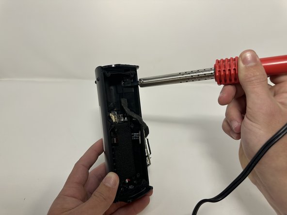

    • Soldering Iron is very hot and can cause injury if not used properly.
    • Use a soldering iron to desolder the outer circuit board from the speaker casing.

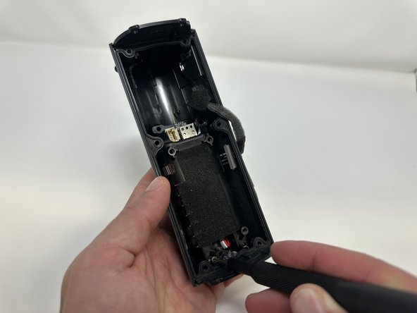

  12. Sonos Roam Inner Circuit Board Replacement, Battery: crwdns2935265:012crwdnd2935265:01crwdnd2935265:02crwdne2935265:0 Sonos Roam Inner Circuit Board Replacement, Battery: crwdns2935265:012crwdnd2935265:02crwdnd2935265:02crwdne2935265:0
  13. Sonos Roam Inner Circuit Board Replacement: crwdns2935265:013crwdnd2935265:01crwdnd2935265:02crwdne2935265:0 Sonos Roam Inner Circuit Board Replacement: crwdns2935265:013crwdnd2935265:02crwdnd2935265:02crwdne2935265:0
    • Use the tweezers to firmly squeeze the middle of the plug.
    • Pull the plug out to remove it from its socket.
    • Remove the battery from the device.

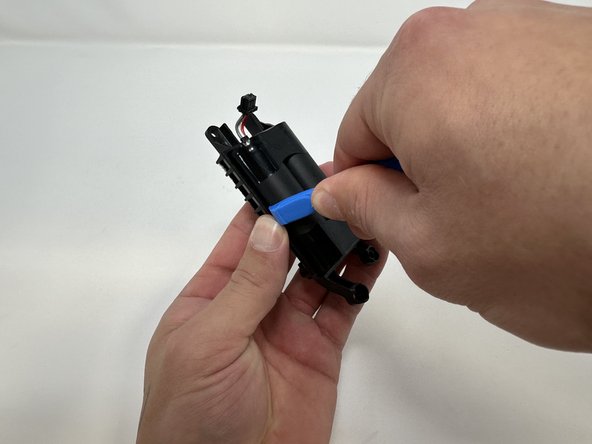

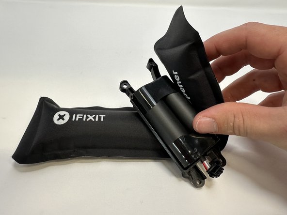

  14. Sonos Roam Inner Circuit Board Replacement: crwdns2935265:014crwdnd2935265:01crwdnd2935265:03crwdne2935265:0 Sonos Roam Inner Circuit Board Replacement: crwdns2935265:014crwdnd2935265:02crwdnd2935265:03crwdne2935265:0 Sonos Roam Inner Circuit Board Replacement: crwdns2935265:014crwdnd2935265:03crwdnd2935265:03crwdne2935265:0
    • Use the iFixit opening tool to pry the battery out of its casing.
    • Use the iOpener, blowdryer, or a similar heating device to loosen the adhesive if having difficulty.
  15. Sonos Roam Inner Circuit Board Replacement: crwdns2935265:015crwdnd2935265:01crwdnd2935265:01crwdne2935265:0
    • Remove the battery from its casing.

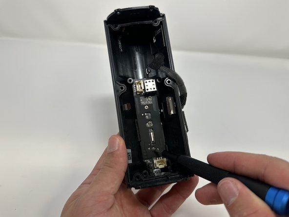

  16. Sonos Roam Inner Circuit Board Replacement, Inner Circuit Board: crwdns2935265:016crwdnd2935265:01crwdnd2935265:02crwdne2935265:0 Sonos Roam Inner Circuit Board Replacement, Inner Circuit Board: crwdns2935265:016crwdnd2935265:02crwdnd2935265:02crwdne2935265:0
    • Use the TR9 Torx screwdriver to remove the two 5 mm screws.

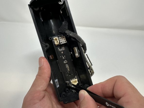

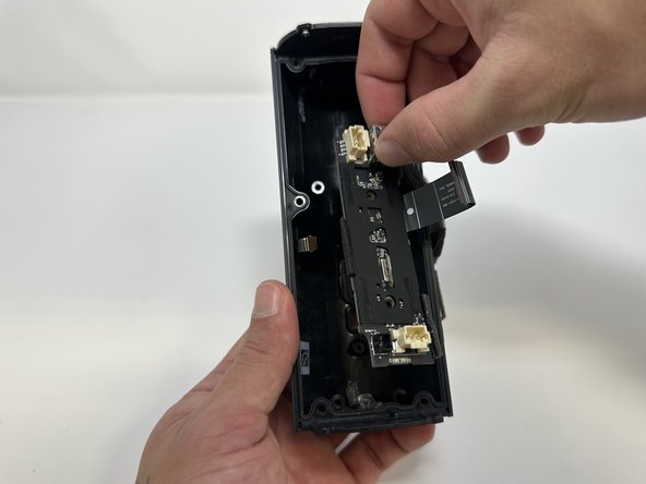

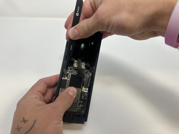

  17. Sonos Roam Inner Circuit Board Replacement: crwdns2935265:017crwdnd2935265:01crwdnd2935265:03crwdne2935265:0 Sonos Roam Inner Circuit Board Replacement: crwdns2935265:017crwdnd2935265:02crwdnd2935265:03crwdne2935265:0 Sonos Roam Inner Circuit Board Replacement: crwdns2935265:017crwdnd2935265:03crwdnd2935265:03crwdne2935265:0
    • Use the tweezers to firmly squeeze the center of the plug.
    • Grab the metal box to remove the inner circuit board.
