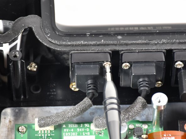

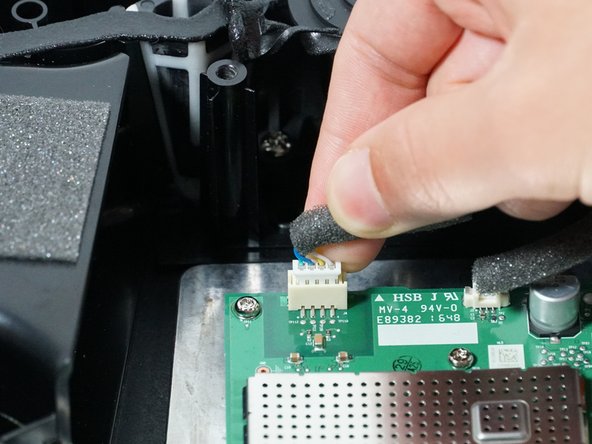

  4. Sonos Playbase Ethernet Port Replacement, Ethernet Port: crwdns2935265:04crwdnd2935265:01crwdnd2935265:02crwdne2935265:0 Sonos Playbase Ethernet Port Replacement, Ethernet Port: crwdns2935265:04crwdnd2935265:02crwdnd2935265:02crwdne2935265:0
    • Unplug the Ethernet Port from the main circuit board by pinching the white clip and pulling upward.

    • Remove the two 18 mm T-10 screws holding the Ethernet Port in place by turning them counterclockwise.

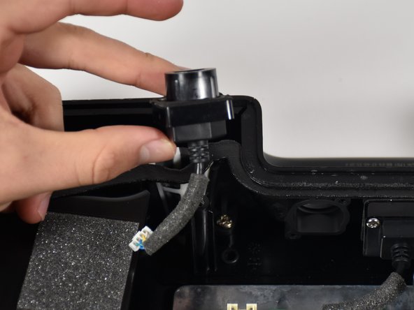

  6. Sonos Playbase Ethernet Port Replacement: crwdns2935265:06crwdnd2935265:01crwdnd2935265:02crwdne2935265:0 Sonos Playbase Ethernet Port Replacement: crwdns2935265:06crwdnd2935265:02crwdnd2935265:02crwdne2935265:0
    • Remove the Ethernet Port from the housing by pinching from both sides and pulling it out.
