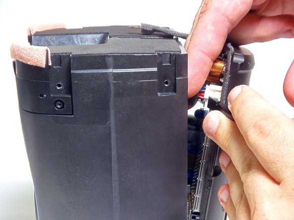

  6. Sonos Play 1 Tweeter Speaker Replacement, Sonos Play 1 Top Cover Disassembly: crwdns2935265:06crwdnd2935265:01crwdnd2935265:01crwdne2935265:0
    • Remove the four 9 mm Torx Security #9 head screws. There are two on each side.
  7. Sonos Play 1 Tweeter Speaker Replacement: crwdns2935265:07crwdnd2935265:01crwdnd2935265:03crwdne2935265:0 Sonos Play 1 Tweeter Speaker Replacement: crwdns2935265:07crwdnd2935265:02crwdnd2935265:03crwdne2935265:0 Sonos Play 1 Tweeter Speaker Replacement: crwdns2935265:07crwdnd2935265:03crwdnd2935265:03crwdne2935265:0

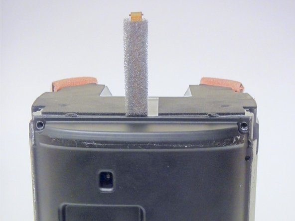

    • Using a plastic opening tool, pry open the top cap containing the power and volume button.
    • Vertically remove the top cap.
    • Be sure to not jerk the top cap when removing , as to not damage the cable linking the switchboard to the motherboard.

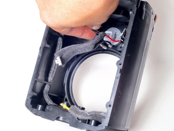

  13. Sonos Play 1 Tweeter Speaker Replacement, Mid-Woofer speaker: crwdns2935265:013crwdnd2935265:01crwdnd2935265:01crwdne2935265:0
    • Remove the two 9mm Torx #9 screws fastening the power cable to the housing.
    • Remove the power cable.
  14. Sonos Play 1 Tweeter Speaker Replacement: crwdns2935265:014crwdnd2935265:01crwdnd2935265:01crwdne2935265:0
    • Using a metal spudger, press the release located in the center of the connector .
    • While pressing the release pull on the connector detaching it from the speaker.
    • Do this for both connections.
  15. Sonos Play 1 Tweeter Speaker Replacement: crwdns2935265:015crwdnd2935265:01crwdnd2935265:02crwdne2935265:0 Sonos Play 1 Tweeter Speaker Replacement: crwdns2935265:015crwdnd2935265:02crwdnd2935265:02crwdne2935265:0
    • Using the Torx T20 bit remove the four 13 mm screws fastening the speaker to the housing.
    • Remove the speaker by lifting it up towards the top of the housing and out at an angle.

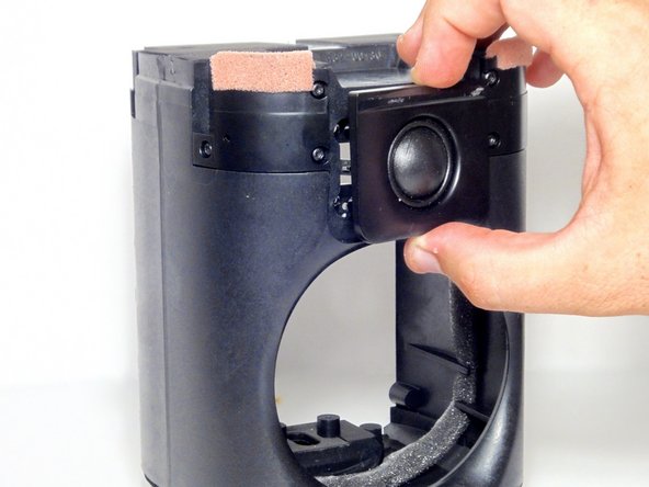

  17. Sonos Play 1 Tweeter Speaker Replacement: crwdns2935265:017crwdnd2935265:01crwdnd2935265:02crwdne2935265:0 Sonos Play 1 Tweeter Speaker Replacement: crwdns2935265:017crwdnd2935265:02crwdnd2935265:02crwdne2935265:0
    • Using a screwdriver, remove the four 10 mm Torx Security #10 screws.
    • Using your fingers, remove the tweeter from the front of the housing.
