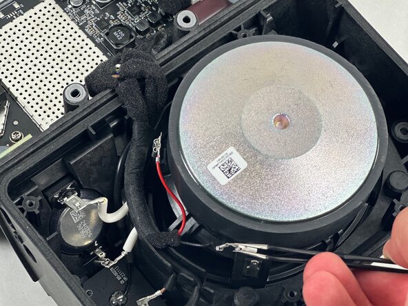

  9. Sonos Era 100 Woofer Replacement, Woofer: crwdns2935265:09crwdnd2935265:01crwdnd2935265:02crwdne2935265:0 Sonos Era 100 Woofer Replacement, Woofer: crwdns2935265:09crwdnd2935265:02crwdnd2935265:02crwdne2935265:0
    • Use tweezers to disconnect the positive and negative wires from the back of the woofer.

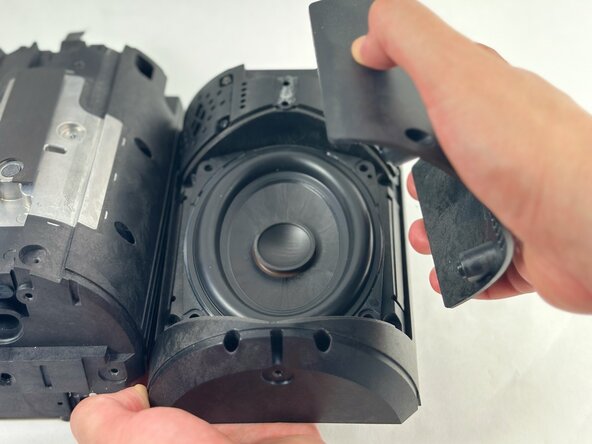

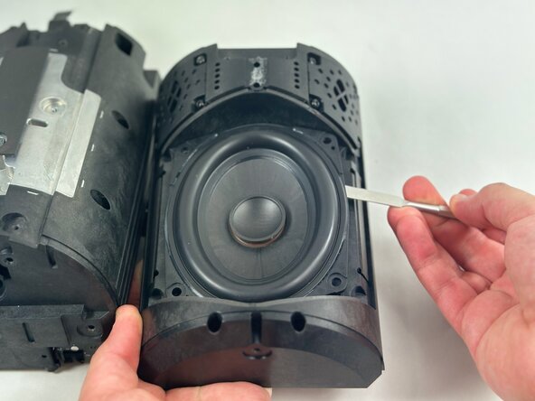

  10. Sonos Era 100 Woofer Replacement: crwdns2935265:010crwdnd2935265:01crwdnd2935265:03crwdne2935265:0 Sonos Era 100 Woofer Replacement: crwdns2935265:010crwdnd2935265:02crwdnd2935265:03crwdne2935265:0 Sonos Era 100 Woofer Replacement: crwdns2935265:010crwdnd2935265:03crwdnd2935265:03crwdne2935265:0
    • Remove all four T20 Torx screws from the woofer cover.
    • Use a spudger to lift the woofer out of its housing.
