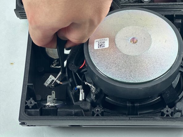

  9. Sonos Era 100 Tweeters Replacement, Tweeters: crwdns2935265:09crwdnd2935265:01crwdnd2935265:02crwdne2935265:0 Sonos Era 100 Tweeters Replacement, Tweeters: crwdns2935265:09crwdnd2935265:02crwdnd2935265:02crwdne2935265:0
    • Use tweezers to disconnect the positive and negative blade connectors from the tweeter.

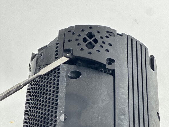

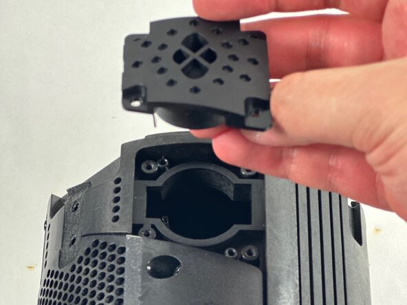

  10. Sonos Era 100 Tweeters Replacement: crwdns2935265:010crwdnd2935265:01crwdnd2935265:03crwdne2935265:0 Sonos Era 100 Tweeters Replacement: crwdns2935265:010crwdnd2935265:02crwdnd2935265:03crwdne2935265:0 Sonos Era 100 Tweeters Replacement: crwdns2935265:010crwdnd2935265:03crwdnd2935265:03crwdne2935265:0
    • Remove the four 11 mm T10 Torx screws from the front of the tweeter assembly.
    • Use a spudger to lift the tweeter out of the housing.
    • Repeat the two previous steps for the other tweeter.
