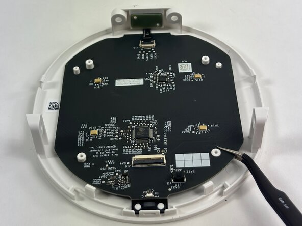

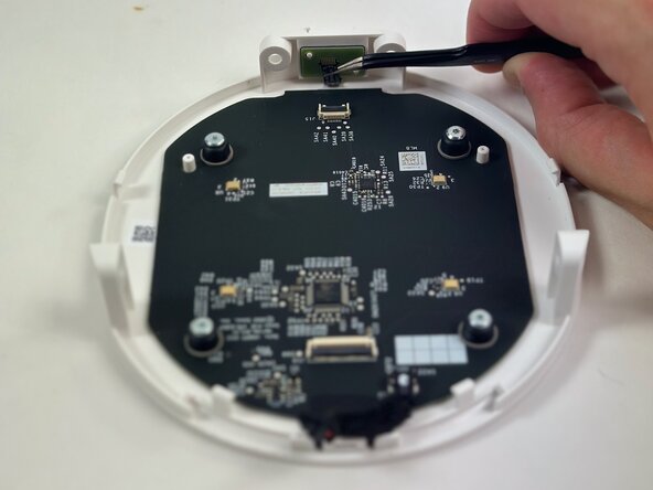

  6. Sonos Era 100 Touch Control Board Replacement, Touch Control Board: crwdns2935265:06crwdnd2935265:01crwdnd2935265:02crwdne2935265:0 Sonos Era 100 Touch Control Board Replacement, Touch Control Board: crwdns2935265:06crwdnd2935265:02crwdnd2935265:02crwdne2935265:0
    • Use tweezers to gently remove the tape securing the small ribbon cable.
    • Flip up the black ZIF locking flap that secures the small ribbon cable.
    • Use tweezers to disconnect the small ribbon cable.

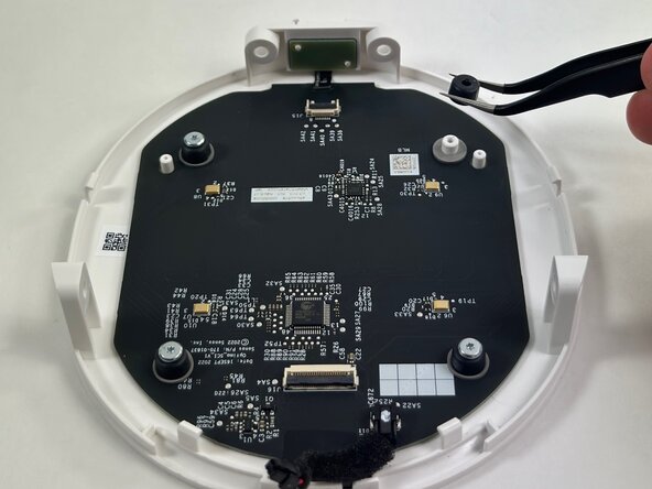

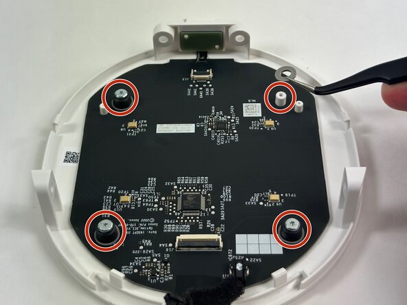

  7. Sonos Era 100 Touch Control Board Replacement: crwdns2935265:07crwdnd2935265:01crwdnd2935265:03crwdne2935265:0 Sonos Era 100 Touch Control Board Replacement: crwdns2935265:07crwdnd2935265:02crwdnd2935265:03crwdne2935265:0 Sonos Era 100 Touch Control Board Replacement: crwdns2935265:07crwdnd2935265:03crwdnd2935265:03crwdne2935265:0
    • Use a T6 Torx screwdriver to remove all four 8 mm screws securing the touch control board to the housing.
    • Use tweezers to remove all four rubber stoppers/washers from the screw posts.

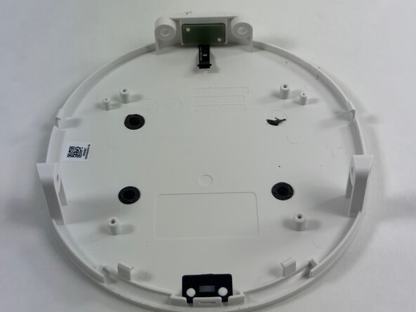

  8. Sonos Era 100 Touch Control Board Replacement: crwdns2935265:08crwdnd2935265:01crwdnd2935265:03crwdne2935265:0 Sonos Era 100 Touch Control Board Replacement: crwdns2935265:08crwdnd2935265:02crwdnd2935265:03crwdne2935265:0 Sonos Era 100 Touch Control Board Replacement: crwdns2935265:08crwdnd2935265:03crwdnd2935265:03crwdne2935265:0
    • Insert an opening pick under the PCB to prop it up.
    • Insert an opening tool under the board and gently pry it out.
    • Remove the touch control board.
