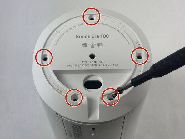

    • Gently pull off the rubber foot on the the bottom of the speaker.
    • Take care not to stretch or damage the rubber foot if you intend to reuse it. Use a hairdryer or iOpener to lightly heat the foot adhesive to aid in removal.
    • Remove the five 11 mm Torx T20 screws that secure the bottom plate.
    • Carefully lift off the bottom plate.

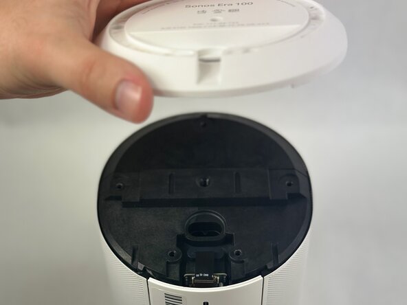

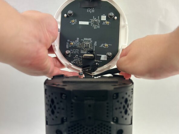

    • Carefully disconnect the ribbon cable connected underneath the bottom panel.
    • To detach the back panel, gently push it in a downward motion.
    • Be especially mindful of the delicate ribbon cable attached to the top edge.
    • Use tweezers to disconnect the USB-C PCB from the back panel.

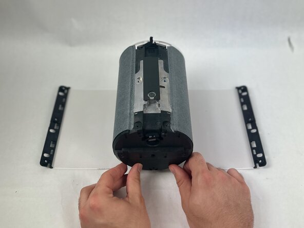

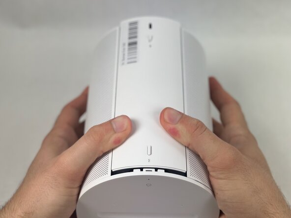

    • Using a halberd spudger, carefully remove the foam tape. Do this by keeping tension on the foam shown in the images and slicing underneath the tape.
    • Pull the speaker grille off.

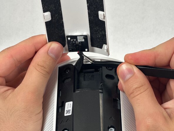

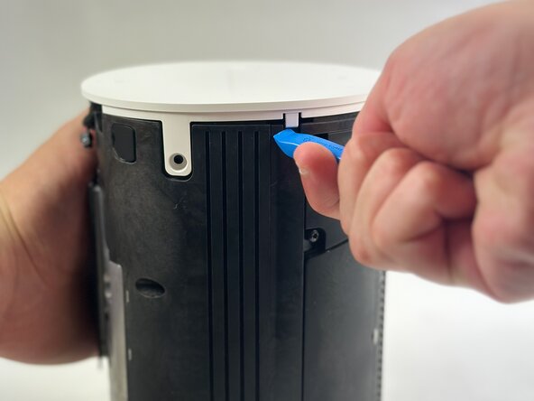

    • Remove all four T10 Torx screws securing the touch bar assembly.
    • Use an opening tool to release all four white retaining clips.
    • Lift the touch bar assembly perpendicular to the unit, with care not to strain the connected ribbon cable.
    • Lift the black ZIF locking flap that secures the touch bar assembly ribbon cable.
    • Disconnect the ribbon cable.
    • Remove the touch bar assembly.

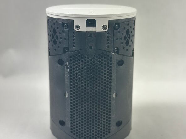

  6. Sonos Era 100 Power Socket Replacement, Speaker Body: crwdns2935265:06crwdnd2935265:01crwdnd2935265:01crwdne2935265:0
    • Remover rubber plugs with a metal spudger

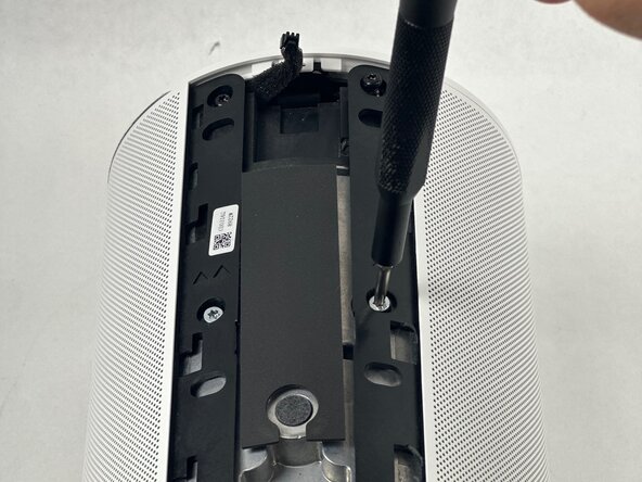

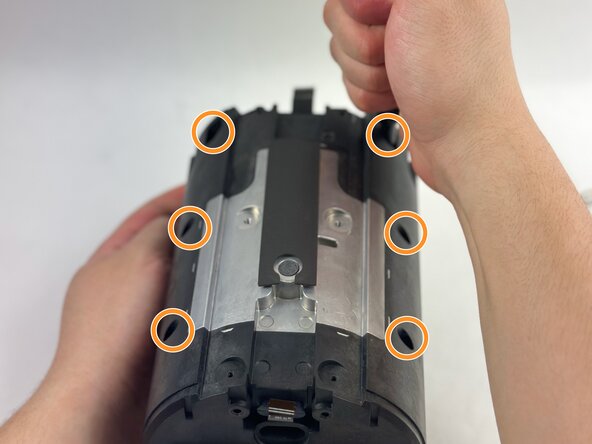

    • Remove front-bottom two T10 Torx 11 mm screws.
    • Remove the six front T10 Torx screws.
  8. Sonos Era 100 Power Socket Replacement: crwdns2935265:08crwdnd2935265:01crwdnd2935265:02crwdne2935265:0 Sonos Era 100 Power Socket Replacement: crwdns2935265:08crwdnd2935265:02crwdnd2935265:02crwdne2935265:0

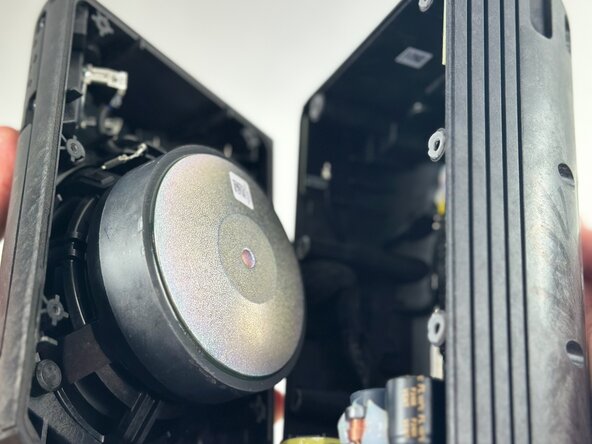

    • Remove the four T10 Torx screws on the back of the device.
    • Pry open the speaker body to access the internals.

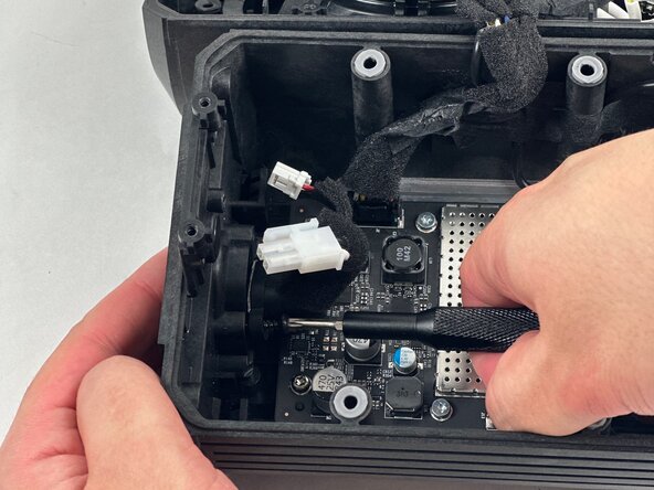

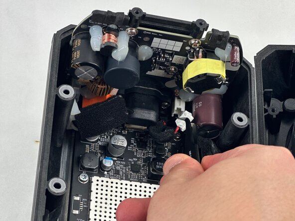

    • Disconnect both of the power supply board connectors from the motherboard.

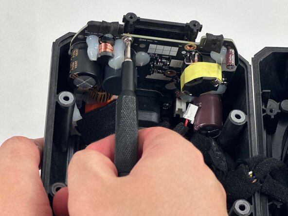

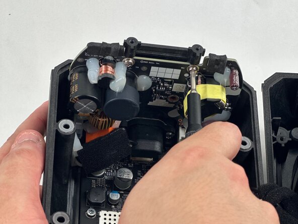

  10. Sonos Era 100 Power Socket Replacement: crwdns2935265:010crwdnd2935265:01crwdnd2935265:03crwdne2935265:0 Sonos Era 100 Power Socket Replacement: crwdns2935265:010crwdnd2935265:02crwdnd2935265:03crwdne2935265:0 Sonos Era 100 Power Socket Replacement: crwdns2935265:010crwdnd2935265:03crwdnd2935265:03crwdne2935265:0
    • Use a T10 Trox screwdriver to remove the three 8 mm screws securing the power supply board.
  11. Sonos Era 100 Power Socket Replacement: crwdns2935265:011crwdnd2935265:01crwdnd2935265:01crwdne2935265:0
    • Carefully remove the board.
