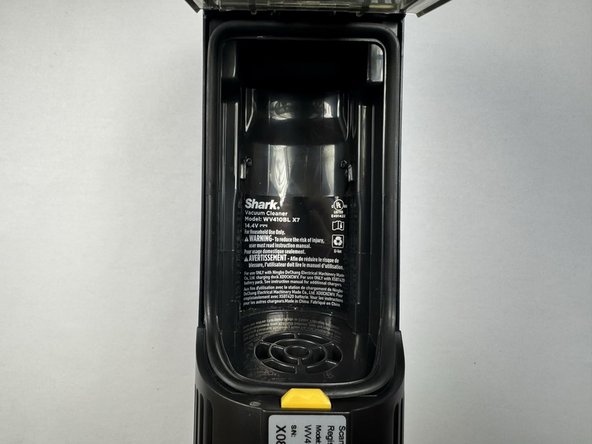

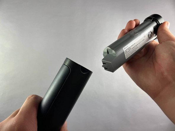

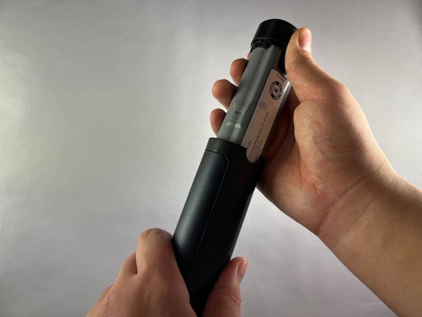

    • Squeeze the tabs at the base of the handle to release the battery from the vacuum.
  2. Shark Wandvac Power Pet WV410 Circuit Board Replacement: crwdns2935265:02crwdnd2935265:01crwdnd2935265:03crwdne2935265:0 Shark Wandvac Power Pet WV410 Circuit Board Replacement: crwdns2935265:02crwdnd2935265:02crwdnd2935265:03crwdne2935265:0 Shark Wandvac Power Pet WV410 Circuit Board Replacement: crwdns2935265:02crwdnd2935265:03crwdnd2935265:03crwdne2935265:0
    • Pull the battery straight out from the bottom of the device.

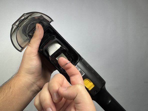

    • Push down on the yellow release tab to open the dust cover.

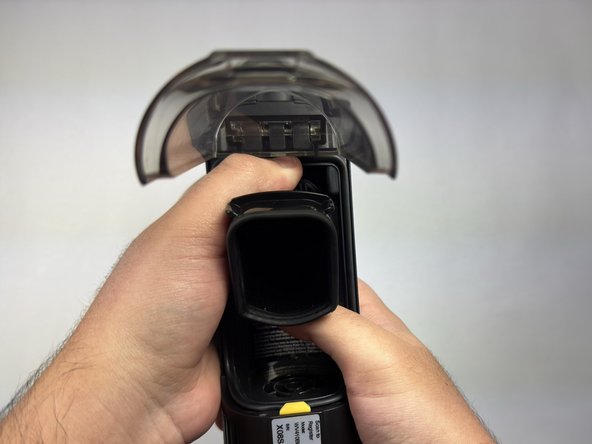

  4. Shark Wandvac Power Pet WV410 Circuit Board Replacement: crwdns2935265:04crwdnd2935265:01crwdnd2935265:02crwdne2935265:0 Shark Wandvac Power Pet WV410 Circuit Board Replacement: crwdns2935265:04crwdnd2935265:02crwdnd2935265:02crwdne2935265:0
    • Firmly pull the filter box forward to reveal the filter opening.

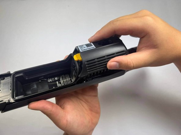

  5. Shark Wandvac Power Pet WV410 Circuit Board Replacement: crwdns2935265:05crwdnd2935265:01crwdnd2935265:03crwdne2935265:0 Shark Wandvac Power Pet WV410 Circuit Board Replacement: crwdns2935265:05crwdnd2935265:02crwdnd2935265:03crwdne2935265:0 Shark Wandvac Power Pet WV410 Circuit Board Replacement: crwdns2935265:05crwdnd2935265:03crwdnd2935265:03crwdne2935265:0
    • Lift the metal ring and pull the fabric filter out of the filter box.

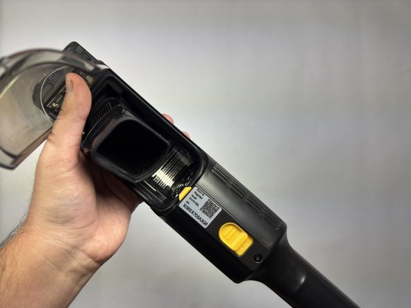

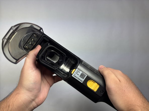

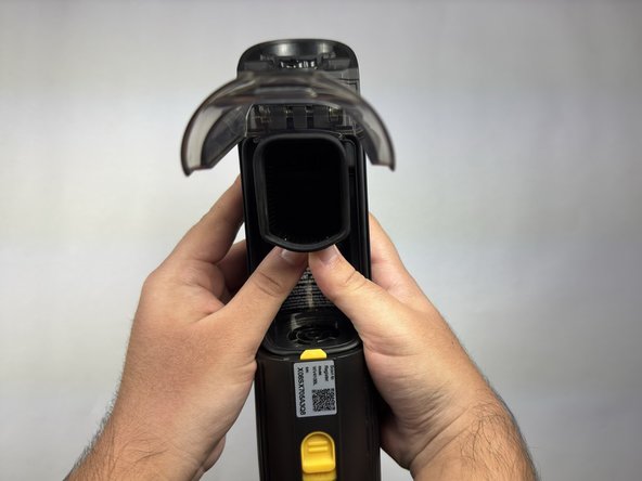

  6. Shark Wandvac Power Pet WV410 Circuit Board Replacement, Filter Cup: crwdns2935265:06crwdnd2935265:01crwdnd2935265:03crwdne2935265:0 Shark Wandvac Power Pet WV410 Circuit Board Replacement, Filter Cup: crwdns2935265:06crwdnd2935265:02crwdnd2935265:03crwdne2935265:0 Shark Wandvac Power Pet WV410 Circuit Board Replacement, Filter Cup: crwdns2935265:06crwdnd2935265:03crwdnd2935265:03crwdne2935265:0
    • Flip up the filter cup and push down with your thumbs towards you.
    • You will hear a pop when it is successfully released.

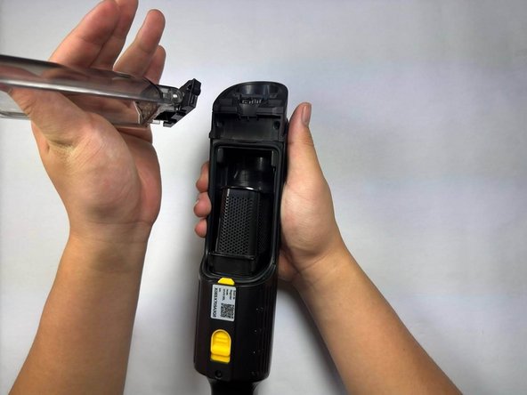

  7. Shark Wandvac Power Pet WV410 Circuit Board Replacement: crwdns2935265:07crwdnd2935265:01crwdnd2935265:02crwdne2935265:0 Shark Wandvac Power Pet WV410 Circuit Board Replacement: crwdns2935265:07crwdnd2935265:02crwdnd2935265:02crwdne2935265:0
    • Remove the cup.

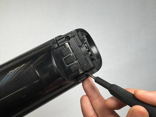

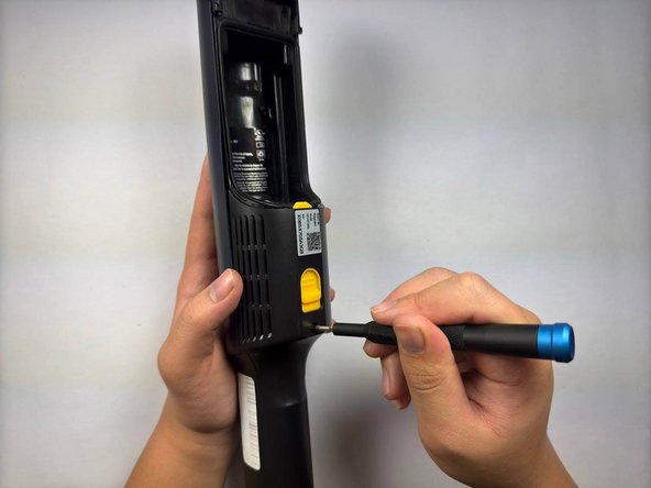

  8. Shark Wandvac Power Pet WV410 Circuit Board Replacement, Dust Cover: crwdns2935265:08crwdnd2935265:01crwdnd2935265:02crwdne2935265:0 Shark Wandvac Power Pet WV410 Circuit Board Replacement, Dust Cover: crwdns2935265:08crwdnd2935265:02crwdnd2935265:02crwdne2935265:0
    • Use a Torx T3 screwdriver to remove the two screws that attach the dust cover to the vacuum.

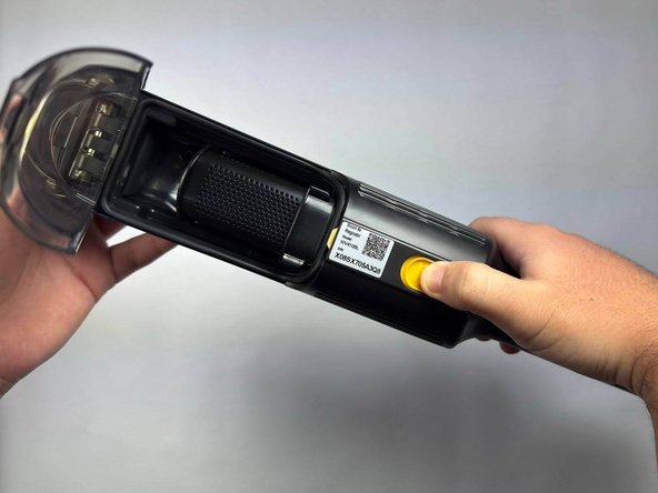

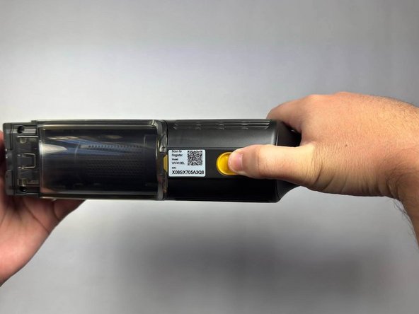

  9. Shark Wandvac Power Pet WV410 Circuit Board Replacement: crwdns2935265:09crwdnd2935265:01crwdnd2935265:01crwdne2935265:0
    • Push and slide the yellow release button down to open the dust cover.
  10. Shark Wandvac Power Pet WV410 Circuit Board Replacement: crwdns2935265:010crwdnd2935265:01crwdnd2935265:02crwdne2935265:0 Shark Wandvac Power Pet WV410 Circuit Board Replacement: crwdns2935265:010crwdnd2935265:02crwdnd2935265:02crwdne2935265:0
    • Remove the dust cover.

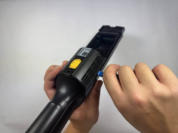

  12. Shark Wandvac Power Pet WV410 Circuit Board Replacement: crwdns2935265:012crwdnd2935265:01crwdnd2935265:03crwdne2935265:0 Shark Wandvac Power Pet WV410 Circuit Board Replacement: crwdns2935265:012crwdnd2935265:02crwdnd2935265:03crwdne2935265:0 Shark Wandvac Power Pet WV410 Circuit Board Replacement: crwdns2935265:012crwdnd2935265:03crwdnd2935265:03crwdne2935265:0

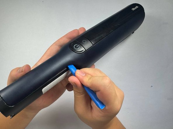

    • Use the plastic opening tool to pry between the seams of the yellow slide button cover and the vacuum frame to release the tabs holding them together.
    • Make sure to release the tabs on both sides of the cover to avoid breaking them.
    • Remove the black cover.

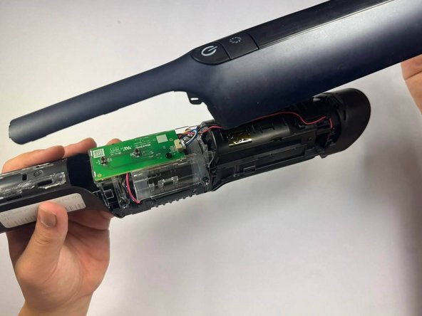

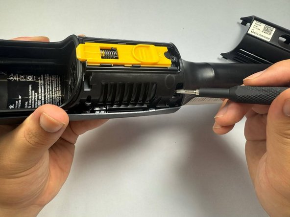

  13. Shark Wandvac Power Pet WV410 Circuit Board Replacement: crwdns2935265:013crwdnd2935265:01crwdnd2935265:02crwdne2935265:0 Shark Wandvac Power Pet WV410 Circuit Board Replacement: crwdns2935265:013crwdnd2935265:02crwdnd2935265:02crwdne2935265:0
    • Use a Torx T3 screwdriver to remove the two screws.
    • These screws must be removed to safely remove the dark blue cover.
  14. Shark Wandvac Power Pet WV410 Circuit Board Replacement: crwdns2935265:014crwdnd2935265:01crwdnd2935265:03crwdne2935265:0 Shark Wandvac Power Pet WV410 Circuit Board Replacement: crwdns2935265:014crwdnd2935265:02crwdnd2935265:03crwdne2935265:0 Shark Wandvac Power Pet WV410 Circuit Board Replacement: crwdns2935265:014crwdnd2935265:03crwdnd2935265:03crwdne2935265:0
    • Pry along the edge of the dark blue cover to remove it.
    • The dark blue cover is glued near the handle so be careful to avoid cracking the cover when removing it.

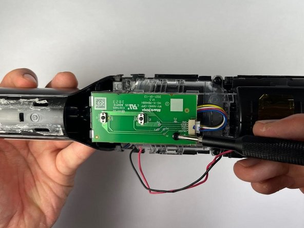

  15. Shark Wandvac Power Pet WV410 Circuit Board Replacement: crwdns2935265:015crwdnd2935265:01crwdnd2935265:02crwdne2935265:0 Shark Wandvac Power Pet WV410 Circuit Board Replacement: crwdns2935265:015crwdnd2935265:02crwdnd2935265:02crwdne2935265:0
    • Use a T3 Torx screwdriver to remove the single screw securing the circuit board.
    • Avoid touching/scratching the circuit board.

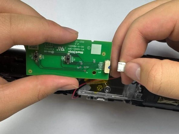

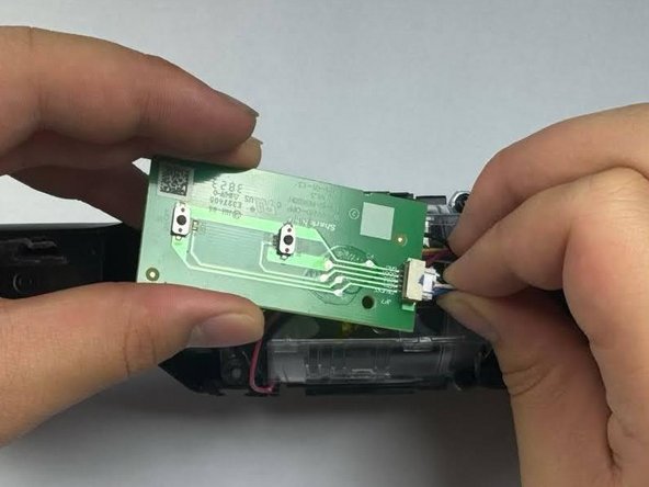

  16. Shark Wandvac Power Pet WV410 Circuit Board Replacement: crwdns2935265:016crwdnd2935265:01crwdnd2935265:03crwdne2935265:0 Shark Wandvac Power Pet WV410 Circuit Board Replacement: crwdns2935265:016crwdnd2935265:02crwdnd2935265:03crwdne2935265:0 Shark Wandvac Power Pet WV410 Circuit Board Replacement: crwdns2935265:016crwdnd2935265:03crwdnd2935265:03crwdne2935265:0
    • Press on the sides of the connector and gently pull it from its socket to disconnect the cable from the circuit board.
    • Don't pull on the wire cable as it may damage the connector or rip the wires out.
    • Remove the circuit board from the vacuum.
