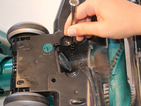

    • Turn the vacuum on its side.
    • Using a quarter, twist the three green locks to the unlock position.
    • Pull the bottom roller brush cover to open the vacuum.

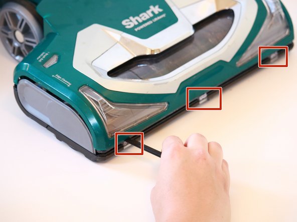

    • Turn the vacuum around.
    • Using a spudger, pry the top of the vacuum cover off. There are three tabs behind each of the clear rectangles below the headlights.

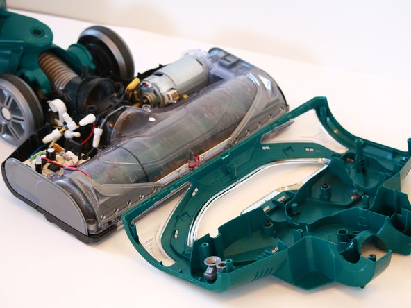

  10. Shark Rotator Powered Lift-Away Speed Belt Replacement: crwdns2935265:010crwdnd2935265:01crwdnd2935265:03crwdne2935265:0 Shark Rotator Powered Lift-Away Speed Belt Replacement: crwdns2935265:010crwdnd2935265:02crwdnd2935265:03crwdne2935265:0 Shark Rotator Powered Lift-Away Speed Belt Replacement: crwdns2935265:010crwdnd2935265:03crwdnd2935265:03crwdne2935265:0

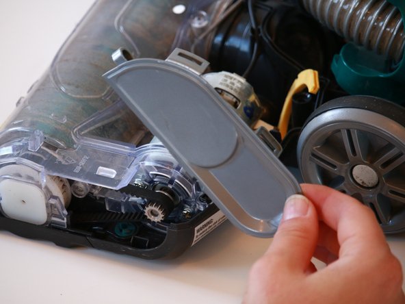

    • Remove the grey side panel on the motor side of the vaccum with a spudger. Pry under each tab to release the side panel.

    • Remove the single 13.4 mm screw located next to where the belt was detached, securing the motor in place, with a PH1 screwdriver.

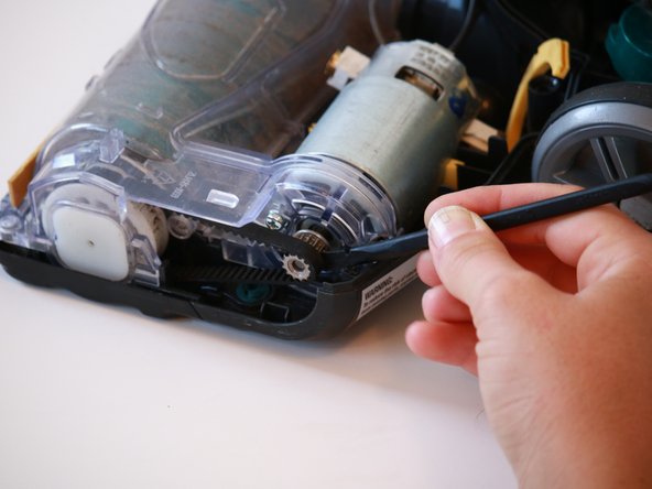

  13. Shark Rotator Powered Lift-Away Speed Belt Replacement: crwdns2935265:013crwdnd2935265:01crwdnd2935265:03crwdne2935265:0 Shark Rotator Powered Lift-Away Speed Belt Replacement: crwdns2935265:013crwdnd2935265:02crwdnd2935265:03crwdne2935265:0 Shark Rotator Powered Lift-Away Speed Belt Replacement: crwdns2935265:013crwdnd2935265:03crwdnd2935265:03crwdne2935265:0
    • Remove the visible side of the belt from the gear with a spudger.

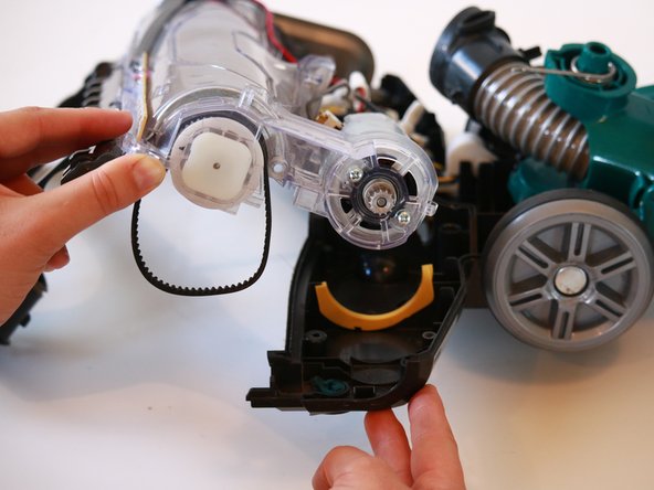

    • Remove the grey panel from the opposite side, by uncrewing the single 13.4 mm screw with a PH1 screwdriver. This will release the container for the roller brush and belt motor.

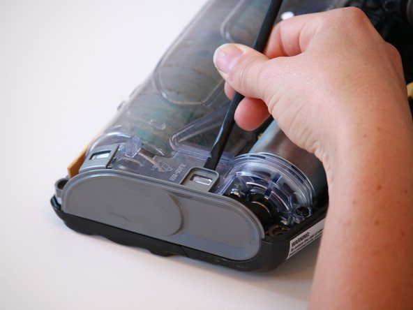

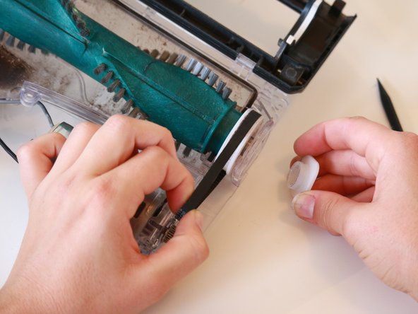

  15. Shark Rotator Powered Lift-Away Speed Belt Replacement: crwdns2935265:015crwdnd2935265:01crwdnd2935265:02crwdne2935265:0 Shark Rotator Powered Lift-Away Speed Belt Replacement: crwdns2935265:015crwdnd2935265:02crwdnd2935265:02crwdne2935265:0
    • Using the spudger, push the white end cap out of the clear plastic by placing the spudger on the roller brush side and pushing the cap outward.

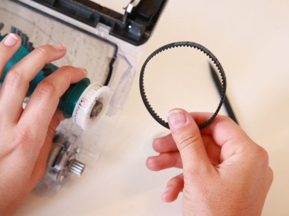

  16. Shark Rotator Powered Lift-Away Speed Belt Replacement: crwdns2935265:016crwdnd2935265:01crwdnd2935265:02crwdne2935265:0 Shark Rotator Powered Lift-Away Speed Belt Replacement: crwdns2935265:016crwdnd2935265:02crwdnd2935265:02crwdne2935265:0
    • Remove the belt from the gear.
