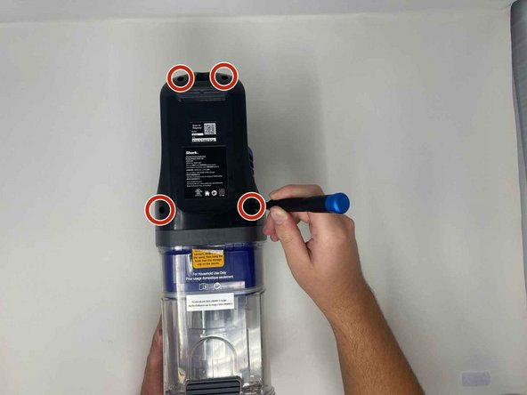

      • Remove the handle base from stick portion of the vacuum for easiest handling. Press the indigo button and slide the handle base away from the stick.
    2. Shark Rocket IX141 Battery Replacement: crwdns2935265:02crwdnd2935265:01crwdnd2935265:01crwdne2935265:0
      • The battery is located on the back of the handle base in the dark grey piece of plastic labeled with the model number.
      • Use a Phillips #1 screwdriver to remove the four 14.5 mm screws in the top and bottom two corners
    3. Shark Rocket IX141 Battery Replacement: crwdns2935265:03crwdnd2935265:01crwdnd2935265:02crwdne2935265:0 Shark Rocket IX141 Battery Replacement: crwdns2935265:03crwdnd2935265:02crwdnd2935265:02crwdne2935265:0
      • The plastic piece from here can be popped off. It may take some effort, so use an opening pick to pry the piece from the base.
      • The battery will now be exposed.
    4. Shark Rocket IX141 Battery Replacement: crwdns2935265:04crwdnd2935265:01crwdnd2935265:03crwdne2935265:0 Shark Rocket IX141 Battery Replacement: crwdns2935265:04crwdnd2935265:02crwdnd2935265:03crwdne2935265:0 Shark Rocket IX141 Battery Replacement: crwdns2935265:04crwdnd2935265:03crwdnd2935265:03crwdne2935265:0
      • You can now remove the battery by lifting it gently from the compartment.
      • Be careful not to damage the metal prongs on the top of the battery.

getting the battery cover off required so much pressure I was afraid it would break, but it didn't (it did go fly across the room when it finally came off, lol)
