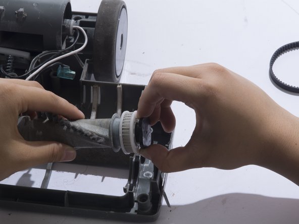

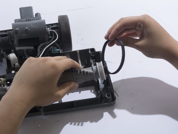

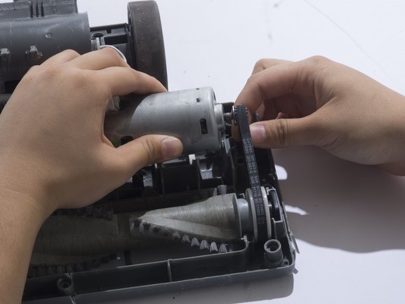

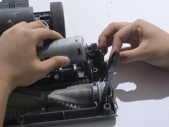

  9. Shark Navigator Lightweight Upright Brush Head Replacement, Brush Head: crwdns2935265:09crwdnd2935265:01crwdnd2935265:03crwdne2935265:0 Shark Navigator Lightweight Upright Brush Head Replacement, Brush Head: crwdns2935265:09crwdnd2935265:02crwdnd2935265:03crwdne2935265:0 Shark Navigator Lightweight Upright Brush Head Replacement, Brush Head: crwdns2935265:09crwdnd2935265:03crwdnd2935265:03crwdne2935265:0
    • Remove the belt, found on the right hand side, from the motor gear.

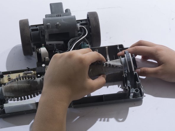

  10. Shark Navigator Lightweight Upright Brush Head Replacement: crwdns2935265:010crwdnd2935265:01crwdnd2935265:03crwdne2935265:0 Shark Navigator Lightweight Upright Brush Head Replacement: crwdns2935265:010crwdnd2935265:02crwdnd2935265:03crwdne2935265:0 Shark Navigator Lightweight Upright Brush Head Replacement: crwdns2935265:010crwdnd2935265:03crwdnd2935265:03crwdne2935265:0
    • Lift up the brush head from the plastic housing, slight force may be needed.
    • Remove the band from the brush head.

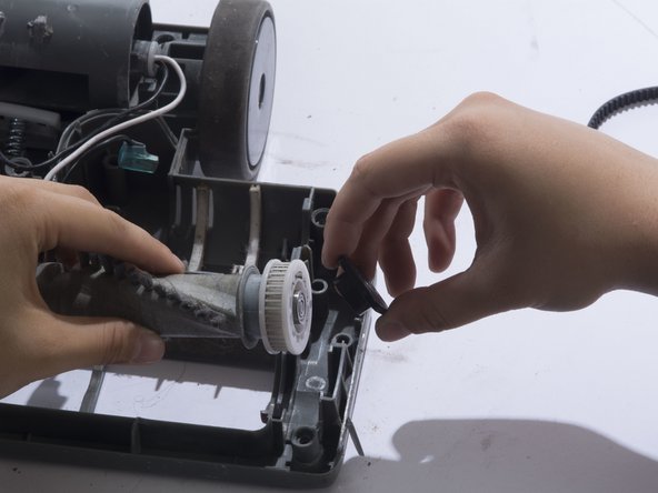

  11. Shark Navigator Lightweight Upright Brush Head Replacement: crwdns2935265:011crwdnd2935265:01crwdnd2935265:03crwdne2935265:0 Shark Navigator Lightweight Upright Brush Head Replacement: crwdns2935265:011crwdnd2935265:02crwdnd2935265:03crwdne2935265:0 Shark Navigator Lightweight Upright Brush Head Replacement: crwdns2935265:011crwdnd2935265:03crwdnd2935265:03crwdne2935265:0
    • Remove the plastic caps on each end of the brush head.
