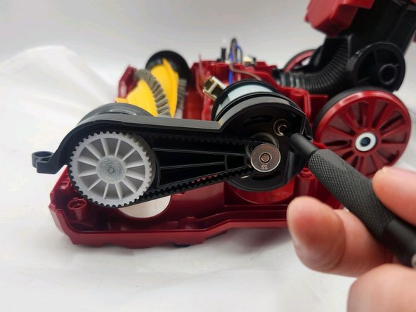

  6. Shark Navigator Lift-Away Zero-M Roller Brush Replacement: crwdns2935265:06crwdnd2935265:01crwdnd2935265:03crwdne2935265:0 Shark Navigator Lift-Away Zero-M Roller Brush Replacement: crwdns2935265:06crwdnd2935265:02crwdnd2935265:03crwdne2935265:0 Shark Navigator Lift-Away Zero-M Roller Brush Replacement: crwdns2935265:06crwdnd2935265:03crwdnd2935265:03crwdne2935265:0
    • Use a Torx TR6 screwdriver to remove the two 10 mm screws that secure the belt.
    • Remove the belt.
