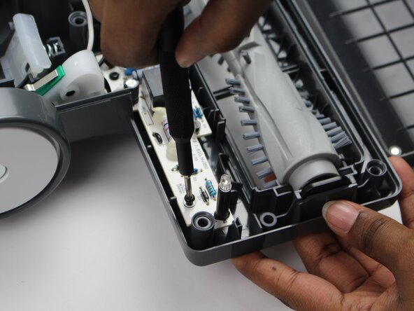

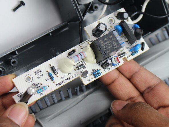

  4. Shark Navigator Lift-Away Pro NV356E V5 Motherboard Replacement, Motherboard: crwdns2935265:04crwdnd2935265:01crwdnd2935265:03crwdne2935265:0 Shark Navigator Lift-Away Pro NV356E V5 Motherboard Replacement, Motherboard: crwdns2935265:04crwdnd2935265:02crwdnd2935265:03crwdne2935265:0 Shark Navigator Lift-Away Pro NV356E V5 Motherboard Replacement, Motherboard: crwdns2935265:04crwdnd2935265:03crwdnd2935265:03crwdne2935265:0
    • Remove the screws on the left and right sides of the motherboard.
    • Remove the motherboard.
