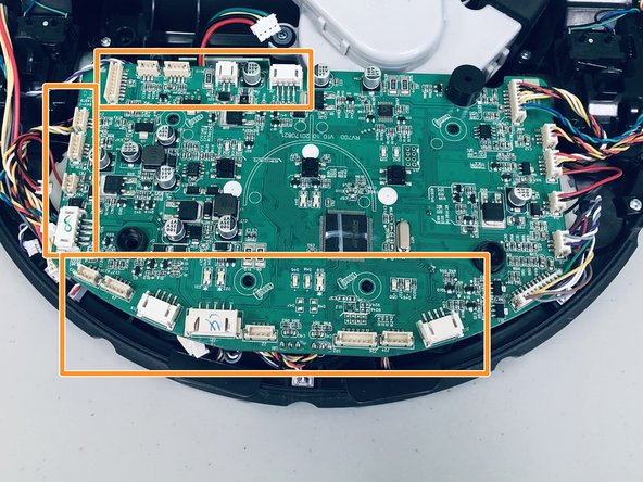

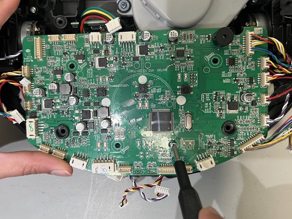

    • Use a Phillips #1 screwdriver to remove the four 11.5 mm screws from the main circuit board.
  8. Shark ION Robot 750 Sensor Replacement: crwdns2935265:08crwdnd2935265:01crwdnd2935265:02crwdne2935265:0 Shark ION Robot 750 Sensor Replacement: crwdns2935265:08crwdnd2935265:02crwdnd2935265:02crwdne2935265:0
    • Use a spudger or tweezers to disconnect the white cable connector from the socket on the motherboard.
    • Detach the 17 connectors from the motherboard.
    • For helpful details on disconnecting different types of connectors, check out the Recognizing & Disconnecting Cable Connectors guide.
    • Don't pull on the cables as they might get damaged and affect the function of the vacuum.

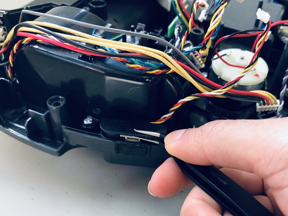

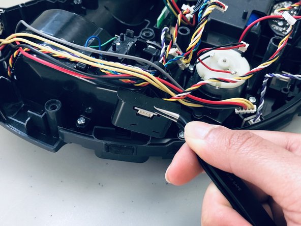

    • Pull the outer case away from the robot vacuum to reveal the sensors.
  10. Shark ION Robot 750 Sensor Replacement: crwdns2935265:010crwdnd2935265:01crwdnd2935265:03crwdne2935265:0 Shark ION Robot 750 Sensor Replacement: crwdns2935265:010crwdnd2935265:02crwdnd2935265:03crwdne2935265:0 Shark ION Robot 750 Sensor Replacement: crwdns2935265:010crwdnd2935265:03crwdnd2935265:03crwdne2935265:0
    • Insert the tweezer between the sensor lid and lower shell.
    • Gently lift each sensor up and out using the tweezer.
