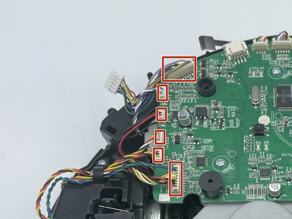

    • Disconnect each of the cable connectors attached to the motherboard to free the wheel assembly from the vacuum for both the left and right wheels.
    • For helpful details on disconnecting different types of connectors, check out the Recognizing and Disconnecting Cable Connectors guide.

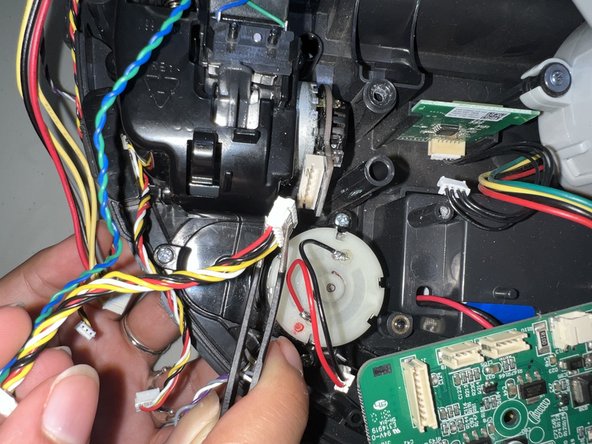

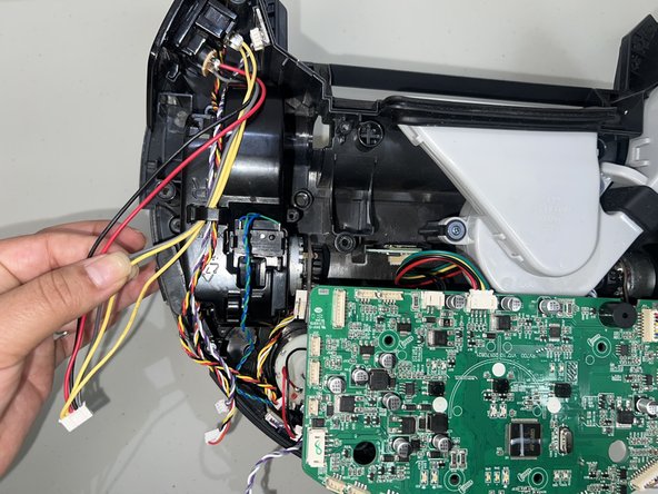

    • Use a spudger or your fingers to detach all of the cables from the connectors on the motherboard that connect to the wheels.
    • This guide demonstrates the right wheel removal but you can use this guide to remove the left wheel assembly as well.
    • Unhook the remaining wires that are connected to the back of the wheel.
    • Do not rip the wires when removing them from the wheel and motherboard.

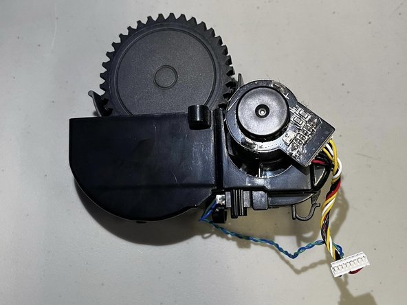

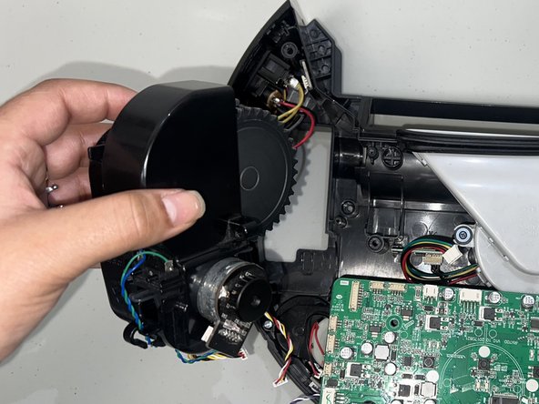

    • Use a Phillips #1 screwdriver to remove the three 12 mm screws that hold the right wheel in place.
    • Be careful not to strip the screws when removing them from the wheel. Take a look at this guide for Screwdriver Best Practices.
    • Remove the right wheel assembly from the socket.
