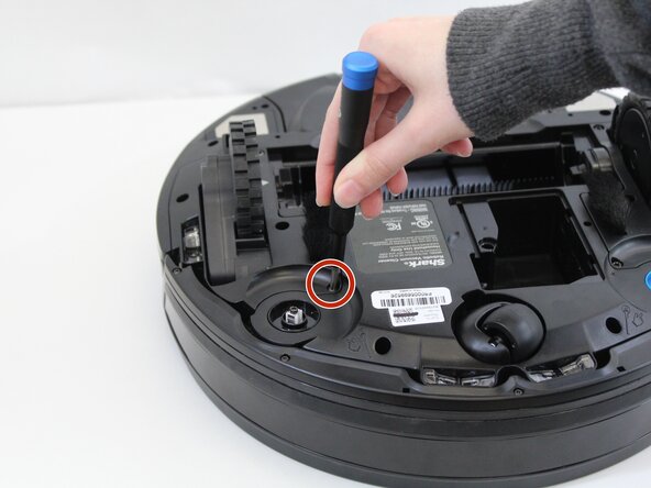

    • Place the unit on its back with the wheels facing up.
    • Use a Phillips #1 screwdriver to remove the single screw securing the battery compartment door.
    • Use your finger to lift off the battery door using the small indent next to it.

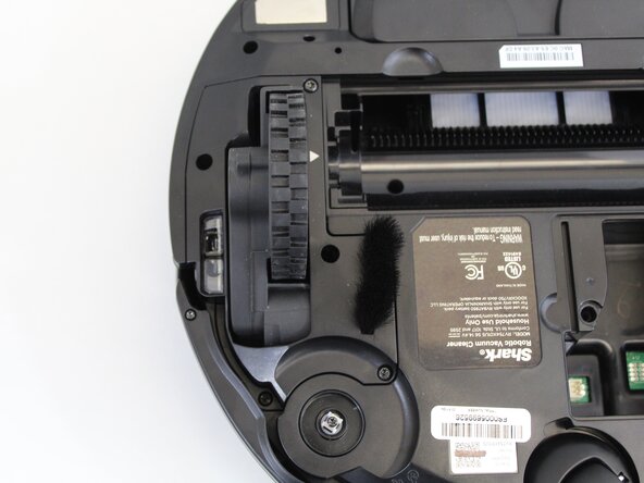

  3. Shark ION RV754 Wheels Replacement, Wheels: crwdns2935265:03crwdnd2935265:01crwdnd2935265:03crwdne2935265:0 Shark ION RV754 Wheels Replacement, Wheels: crwdns2935265:03crwdnd2935265:02crwdnd2935265:03crwdne2935265:0 Shark ION RV754 Wheels Replacement, Wheels: crwdns2935265:03crwdnd2935265:03crwdnd2935265:03crwdne2935265:0
    • Use a TR15 Torx security screwdriver to remove five 13.85 mm screws from the left and right wheel assemblies.

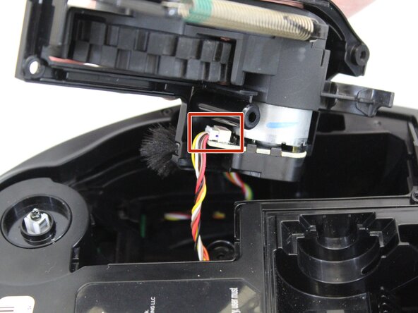

    • Lift the wheel assembly out to access the cable connectors that are attached to the wheels.
    • Squeeze the tab against the connector and pull it straight out to disconnect it from the wheel.

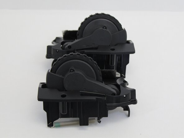

    • Remove the wheel assembly.
    • Repeat the steps to remove the other wheel.
