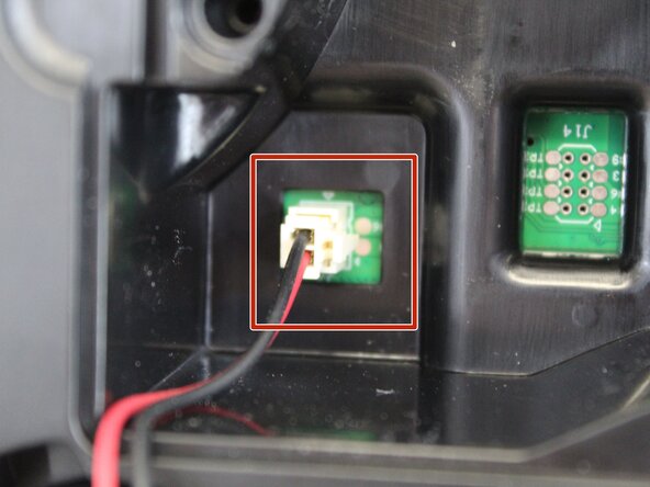

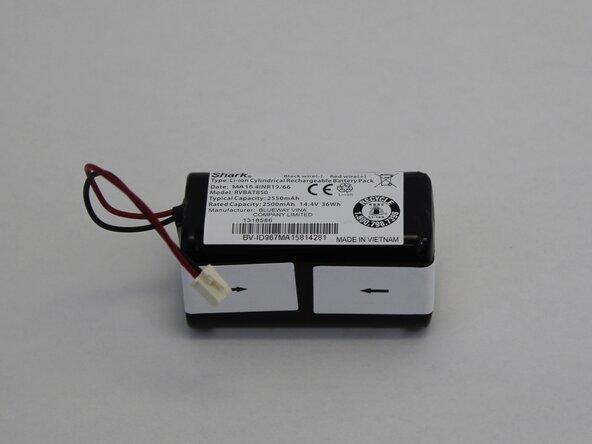

    • Lift the battery out just above the compartment to access the battery connector.
    • Squeeze the tab against the connector and pull it straight up to disconnect it.
    • Remove the battery completely.
To reassemble your device, follow these instructions in reverse order. Take your e-waste to an R2 or e-Stewards certified recycler.
