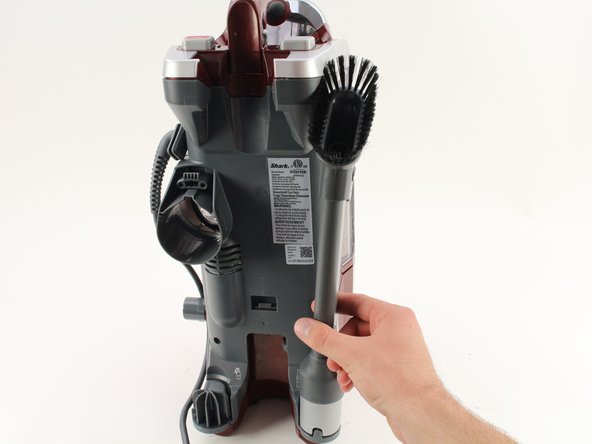

    • Press the Hose Release button and pull back to detach the hose.
  2. Shark DuoClean Powered Lift-Away Speed Power Cable/Connector Replacement: crwdns2935265:02crwdnd2935265:01crwdnd2935265:02crwdne2935265:0 Shark DuoClean Powered Lift-Away Speed Power Cable/Connector Replacement: crwdns2935265:02crwdnd2935265:02crwdnd2935265:02crwdne2935265:0
    • Press the Wand Release button and pull up on the metal tube to remove the entire hose.
  3. Shark DuoClean Powered Lift-Away Speed Power Cable/Connector Replacement: crwdns2935265:03crwdnd2935265:01crwdnd2935265:02crwdne2935265:0 Shark DuoClean Powered Lift-Away Speed Power Cable/Connector Replacement: crwdns2935265:03crwdnd2935265:02crwdnd2935265:02crwdne2935265:0
    • Press the Lift Away button and pull up on the handle to separate the top of the vacuum from the bottom.
  4. Shark DuoClean Powered Lift-Away Speed Power Cable/Connector Replacement: crwdns2935265:04crwdnd2935265:01crwdnd2935265:02crwdne2935265:0 Shark DuoClean Powered Lift-Away Speed Power Cable/Connector Replacement: crwdns2935265:04crwdnd2935265:02crwdnd2935265:02crwdne2935265:0
    • Pull up on the extra brush pieces to remove them from the vacuum.

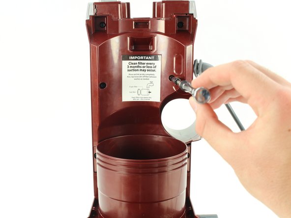

    • Use the T20 screwdriver to remove the two 12 mm screws by turning counterclockwise.
    • Use the T20 screwdriver to remove the two 17 mm screws by turning counterclockwise.
    • Use the T20 screwdriver to remove the two 14 mm screws by turning counterclockwise.

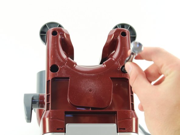

  9. Shark DuoClean Powered Lift-Away Speed Power Cable/Connector Replacement: crwdns2935265:09crwdnd2935265:01crwdnd2935265:02crwdne2935265:0 Shark DuoClean Powered Lift-Away Speed Power Cable/Connector Replacement: crwdns2935265:09crwdnd2935265:02crwdnd2935265:02crwdne2935265:0
    • Use the T20 screwdriver to remove the three 15 mm screws by turning counterclockwise.
    • Use the T10 screwdriver to remove the one 17 mm screw by turning counterclockwise.

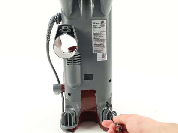

  10. Shark DuoClean Powered Lift-Away Speed Power Cable/Connector Replacement: crwdns2935265:010crwdnd2935265:01crwdnd2935265:02crwdne2935265:0 Shark DuoClean Powered Lift-Away Speed Power Cable/Connector Replacement: crwdns2935265:010crwdnd2935265:02crwdnd2935265:02crwdne2935265:0
    • Use the T20 screwdriver to remove the four 14 mm screws from the bottom of the vacuum by turning counterclockwise.
    • The grey plastic cylinders will detach.

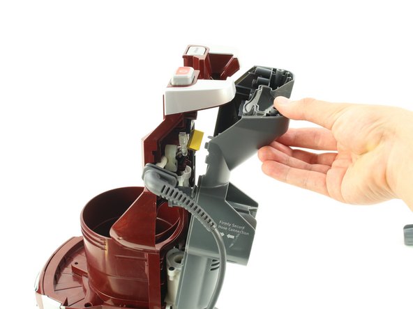

  11. Shark DuoClean Powered Lift-Away Speed Power Cable/Connector Replacement: crwdns2935265:011crwdnd2935265:01crwdnd2935265:02crwdne2935265:0 Shark DuoClean Powered Lift-Away Speed Power Cable/Connector Replacement: crwdns2935265:011crwdnd2935265:02crwdnd2935265:02crwdne2935265:0
    • Use the metal spudger to pry off the back panel.
    • Be careful not to break or snap any plastic.
