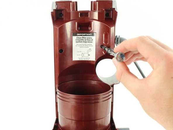

    • Use the T20 screwdriver to remove the three 15 mm screws by turning counterclockwise.
    • Use the T10 screwdriver to remove the one 17 mm screw by turning counterclockwise.

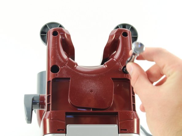

    • Use the T20 Screwdriver to remove the four 14 mm screws from the bottom of the vacuum by turning counterclockwise.
    • The grey plastic cylinders will detach.

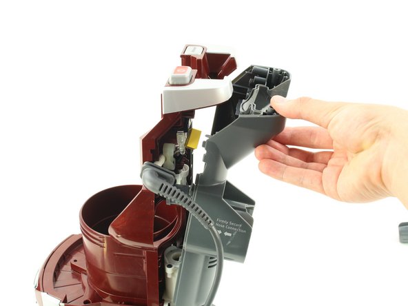

  11. Shark DuoClean Powered Lift-Away Speed Motor Replacement: crwdns2935265:011crwdnd2935265:01crwdnd2935265:02crwdne2935265:0 Shark DuoClean Powered Lift-Away Speed Motor Replacement: crwdns2935265:011crwdnd2935265:02crwdnd2935265:02crwdne2935265:0
    • Use the metal spudger to pry off the back panel.
    • Be careful not to break or snap any plastic.

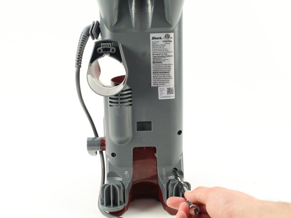

    • Use the T20 screwdriver to remove the one 14 mm screw from the bottom by turning counter clockwise.
    • For reassembly, this screw is difficult to put back in. It is supposed to be very tight.

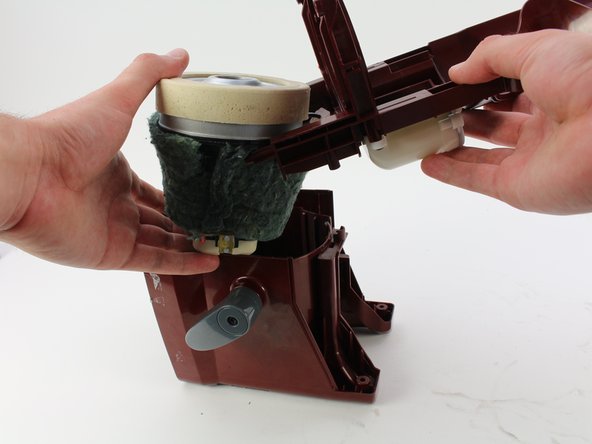

  14. Shark DuoClean Powered Lift-Away Speed Motor Replacement: crwdns2935265:014crwdnd2935265:01crwdnd2935265:02crwdne2935265:0 Shark DuoClean Powered Lift-Away Speed Motor Replacement: crwdns2935265:014crwdnd2935265:02crwdnd2935265:02crwdne2935265:0
    • Pull up and back in a twisting motion to remove the motor from its casing.
    • The wire connected to the motor may make it difficult to remove. It may require a lot of wiggling to get the motor out.

In step 11 there are two additional torx screws to remove, under the finish caps near power and lift away buttons

I just replaced the motor in a Shark AZ1000W which is similar to this except for the screws in different locations. In step 11, similar to what Phil’s comment says above, there is a screw underneath the dust cup release button. You have to pry that button off. To get that top piece off there are two additional screws on top and one on the bottom. Also in the AZ1000W there is a gray trim piece that goes around the HEPA filter and wraps around the back of the unit. You have to remove that before proceeding to step 14. The trim has two halves you have to separate at the seams where they come together. There are tabs holding it together and it’s hard to separate the halves without breaking the plastic holding it together.

My NV752 looks almost just like this until step 13 and 14. It seems like the screw in step 13 doesn't exist, and like there's no way to access the motor. The pinwheel fan-looking part that they pull back in step 14 is fixed to the vacuum, it's the same piece of plastic as the base. I don't think there's any way to get into the motor for NV752 : (
