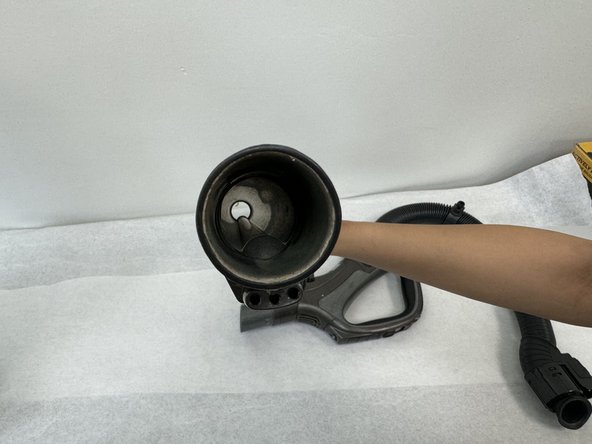

    • Press the button titled "Hose Release" to detach the hose from the dust cup.
  2. Shark Apex DuoClean Powered Lift-Away AZ1002 Hose Replacement: crwdns2935265:02crwdnd2935265:01crwdnd2935265:02crwdne2935265:0 Shark Apex DuoClean Powered Lift-Away AZ1002 Hose Replacement: crwdns2935265:02crwdnd2935265:02crwdnd2935265:02crwdne2935265:0
    • Check the hose and opening on the back of the connector for blockages and remove any that you encounter.

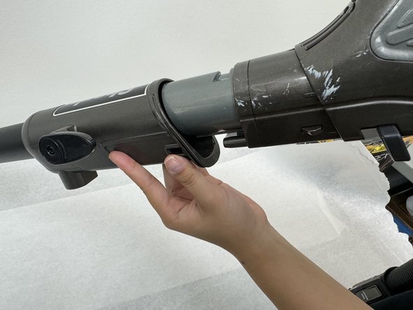

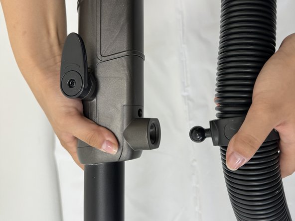

    • Disconnect the hose attachment in the middle of the wand.

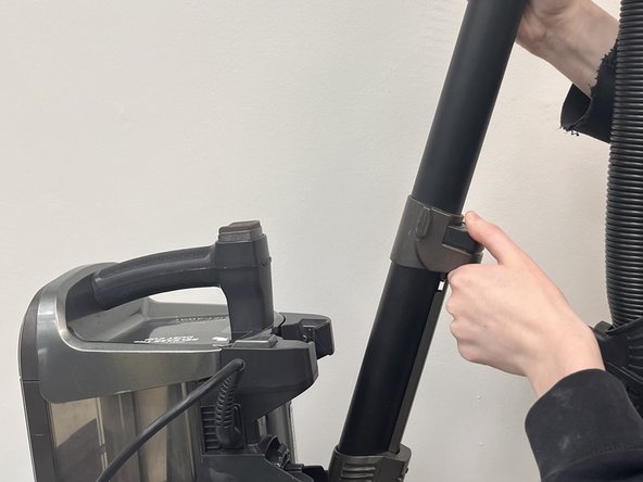

  4. Shark Apex DuoClean Powered Lift-Away AZ1002 Hose Replacement: crwdns2935265:04crwdnd2935265:01crwdnd2935265:03crwdne2935265:0 Shark Apex DuoClean Powered Lift-Away AZ1002 Hose Replacement: crwdns2935265:04crwdnd2935265:02crwdnd2935265:03crwdne2935265:0 Shark Apex DuoClean Powered Lift-Away AZ1002 Hose Replacement: crwdns2935265:04crwdnd2935265:03crwdnd2935265:03crwdne2935265:0

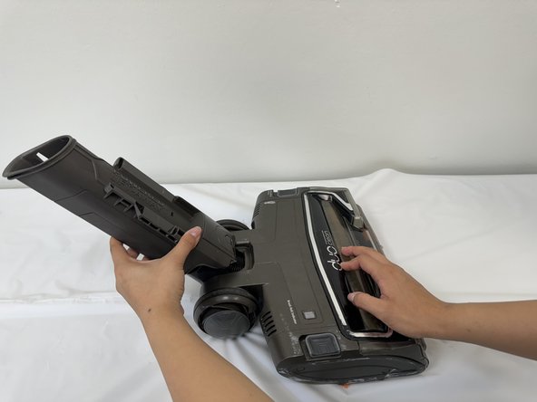

    • Detach the wand from the floor nozzle by pressing the button titled "Wand Release."
    • Check the opening of the bottom of the wand for blockages and remove any that you encounter.

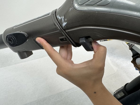

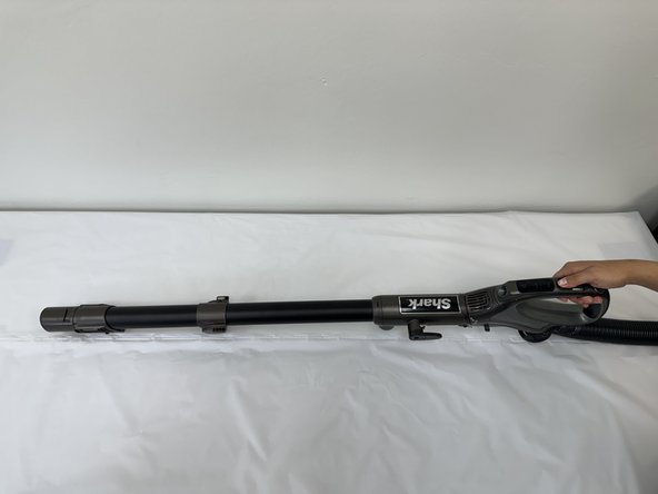

  5. Shark Apex DuoClean Powered Lift-Away AZ1002 Hose Replacement: crwdns2935265:05crwdnd2935265:01crwdnd2935265:03crwdne2935265:0 Shark Apex DuoClean Powered Lift-Away AZ1002 Hose Replacement: crwdns2935265:05crwdnd2935265:02crwdnd2935265:03crwdne2935265:0 Shark Apex DuoClean Powered Lift-Away AZ1002 Hose Replacement: crwdns2935265:05crwdnd2935265:03crwdnd2935265:03crwdne2935265:0
    • Detach the handle by pressing the button titled "Handle Release."
    • Check the opening at the top of the wand and the opening of the handle for any blockages and remove any that you encounter.
    • Keep the handle removed from the wand.

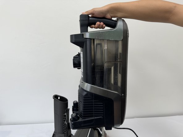

    • Detach the dust cup from the floor nozzle.
  7. Shark Apex DuoClean Powered Lift-Away AZ1002 Hose Replacement: crwdns2935265:07crwdnd2935265:01crwdnd2935265:03crwdne2935265:0 Shark Apex DuoClean Powered Lift-Away AZ1002 Hose Replacement: crwdns2935265:07crwdnd2935265:02crwdnd2935265:03crwdne2935265:0 Shark Apex DuoClean Powered Lift-Away AZ1002 Hose Replacement: crwdns2935265:07crwdnd2935265:03crwdnd2935265:03crwdne2935265:0

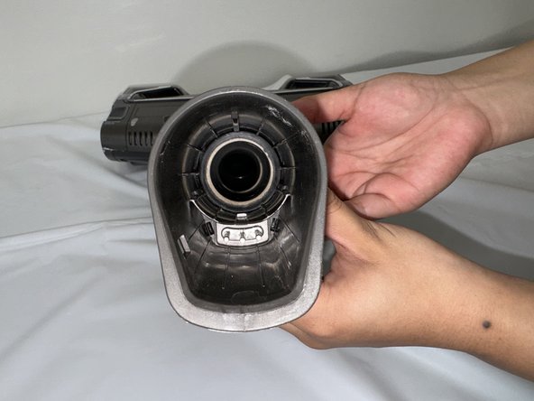

    • Tilt the floor nozzle downwards.
    • Check the opening of the floor nozzle for blockages and remove any that you encounter.
