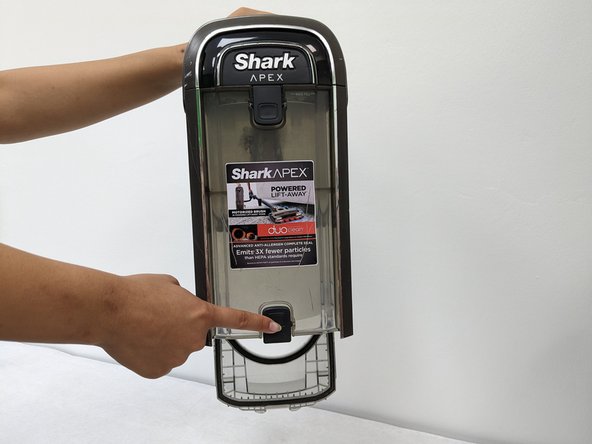

    • Press the dust cup release button.
  2. Shark Apex DuoClean Powered Lift-Away AZ1002 Dust Cup Replacement: crwdns2935265:02crwdnd2935265:01crwdnd2935265:01crwdne2935265:0
    • Use the handle to tilt the dust cup away from the wand, then lift upwards to fully free the dust cup.

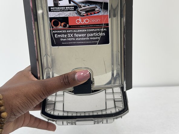

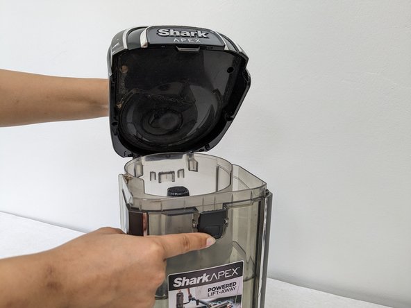

    • Hold the duct cup over a trash bin.
    • Press the button at the base of the cup to release the door.
    • The door will swing down and the dirt will fall into the trash.

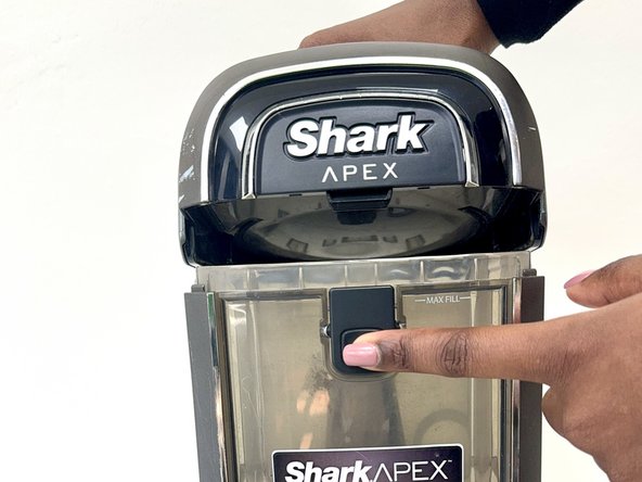

    • Push the button at the top of the dust cup to release the lid.
    • Use the handle to open it.

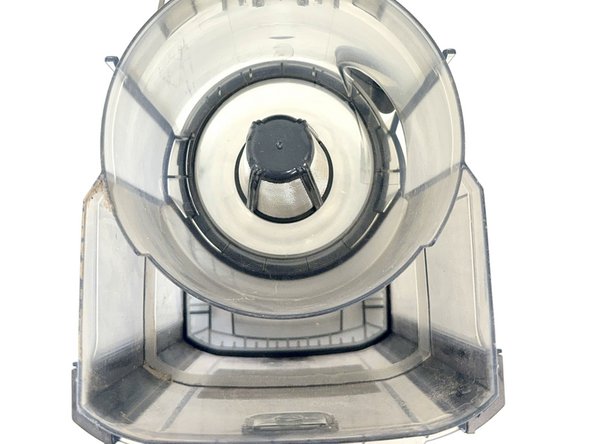

    • Make sure the cone-shaped filter is free from any debris, pebbles or other materials that could lead to blockages.
To reassemble your device, follow these instructions in reverse order. Everything will snap back into place with a click.
